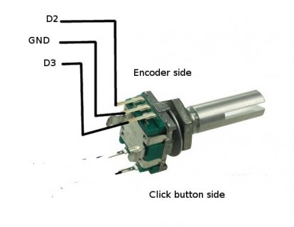

When I write this line Encoder myEnc(2, 3); in the below code (RAM LOADING + KEYPAD etc), the RAM loading speed becomes very slow. All files loading to PSRAM take 35+ seconds
code is with affected running Speed :

very very slow speed of " LOADING FILES to PSRAM" in void setup() you can see in this Video
However, the loading files to PSRAM speed is quite good. if i don't use of Encoder myEnc(2, 3); in my code , all files Loading to PSRAM takes 1 second only.
Please tell me under what circumstances this happens.
I want to know the details of it.
Looks like it will bother me if I mix more code like Display etc.

A couple of points :
- Can you show me a picture of how you have connected your encoders
- Are you using a decent quality card, do you have another one you can try
Cheers Paul
Thankyou....paul
Encoder wiring is this way. I have same this encoder.my sd Card is SanDisk ultra fast 64 gb card is working fine. Problem occurred only when I add rotary encoder's code to my main code ,as you are seeing in Post #1 codes. I think very tinny mistake make this problem. That is out of my search...
I can't replicate your problem - for me both sets of code at post #1 work well under 1s.

But no change was seen. My circuit might seem unsightly to you, but this is due to space constraints.
Its actual pins diagram is something like this
I used the exact same encoder you see in the picture.
Note here ..... the keypad pins(39 and 40 ) are connected to the encoder's Push buttons
. all keys from keypad diode protected.
