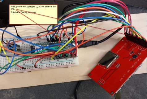

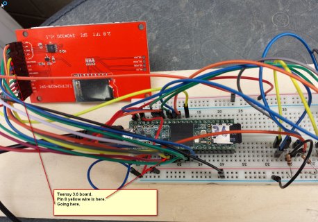

Color 320x240 TFT Touchscreen - Touch Help
rfresh737
I'm having trouble getting the Color 320x240 TFT Touchscreen I purchased from here, to recognize touch.
I had this working on a 3.2 and now I trying to use a 3.6 I recently purchased. I'm thinking it has something to do with the 3.6 board, but I don't know for sure.
I've stripped down my code to just the touch function to keep it simple.
I'm hoping someone can see what I'm doing wrong.
Thank you...

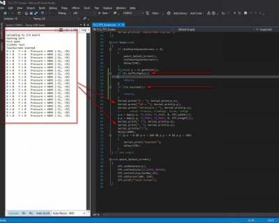

Here is what I see in my serial window:
X = 0	Y = 0	Pressure = 4095 (-31, -39)
And here is current code with some of your code snippets:

What happens if you, add:
if (! ts.touched()) {
return;
In loop right after your test for if (intPaintSplashScreen) code, ie right before the getPoint... I usually have this when I am doing printing as to not get a bunch of not pressed...
Kurt
Edit: Again forgot to mention my loop starts off by checking to see if there is any TS data available:
  // See if there's any  touch data for us
  if (ts.bufferEmpty()) {
    return;
Edit: The complete example one is up on my github, but is setup for my ILI9241_t3n library which uses SPIN to work on different SPI buses. https://github.com/KurtE/ILI9341_t3n/tree/master/examples/touchpaint_xpt2046
Please see attachment.

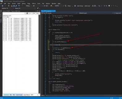

I added both of your suggested blocks of code.
The x y pressure serial print code is still getting executed.
#include "SPI.h"
#include "ILI9341_t3.h"
#include "font_Georgia.h"
#include "font_CourierNew.h"
#define TS_MINX 337
#define TS_MINY 529
#define TS_MAXX 3729
#define TS_MAXY 3711
#define CS_PIN  8
#define TFT_DC  9
#define TFT_CS 10
XPT2046_Touchscreen ts(CS_PIN);
TS_Point p;
int intPaintSplashScreen = 0;
	tft.begin();
	tft.setRotation(1);
	while (!Serial & millis() <4000)
	Serial.println("ILI9341 Test");
	if (!ts.begin())
		Serial.println("Couldn't start touchscreen controller");
		while (1);
	Serial.println("Touchscreen started");
void loop(void)
	if (intPaintSplashScreen == 0)
		paint_Splash_Screen();
		intPaintSplashScreen++;
		delay(250);
	TS_Point p = ts.getPoint();
		return;
	if (!ts.touched())
		return;
	Serial.print("X = "); Serial.print(p.x);
	Serial.print("\tY = "); Serial.print(p.y);
	Serial.print("\tPressure = "); Serial.print(p.z);
	//      value, fromLow, fromHigh, toLow, toHigh
	p.x = map(p.x, TS_MINX, TS_MAXX, 0, tft.width());
	p.y = map(p.y, TS_MINY, TS_MAXY, 0, tft.height());
	Serial.print(" ("); Serial.print(p.x);
	Serial.print(", "); Serial.print(p.y);
	Serial.println(")");
	if (p.x > 0 && p.x < 200 && p.y > 0 && p.y < 200)
		Serial.print("touched!");
		delay(250);
} // end Loop()
void paint_Splash_Screen()
	tft.setRotation(1);
	tft.setTextColor(ILI9341_GREEN);
	tft.setFont(CourierNew_14);
	tft.setCursor(106, 110);
	tft.print("Touch Screen");

I added #include <XPT2046_Touchscreen.h> See current code block below.
I put the is empty test before the get point statement. See attachments.
I'm attaching two pictures showing T_CS (one of my yellow wires) going to pin 8 of the Teensy 3.6

Thanks, I can not make out all of the wires, so I would double check all of the wiring of the SPI Touch.
From the PJRC Website:
_CLK	13 (SCK)	14
T_CS	8	8	Alternate: any digital pin
T_DIN	11 (DOUT)	7
T_DO	12 (DIN)	12
T_IRQ	2	2	Optional: can use any digital pin
For example in you pictures I only see what appears to be one wire going to 13 for the CLK, but both the processor and the Touch require it. Again it may be there already but could not easily follow the wires
Success!
I kept forgetting on the 3.6 pin 13 is on the 'other side' and I didn't have both wires going to it. You saw it but I kept over looking it.
Much thanks Kurt for hanging in there with me to get this resolved!
