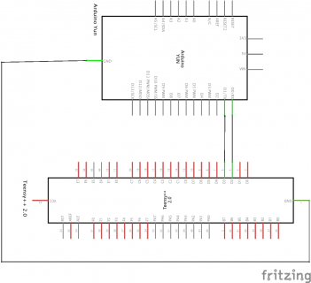

Heja, GREAT!, that worked! I have a running bridge from a teensy++ 2.0 to the AR9331 of a yun and into the internet using only two wires (teensy++ pin D2 to yun pin 0; teensy++ pin D3 to yun pin 1)!
Setup:
BTW: To make sure that the 32u4 on the arduino yun board doesn't interfere with the bridge, one should not use Serial1 on the 32u4. I even uploaded a sketch as follows to the 32u4 on the yun:

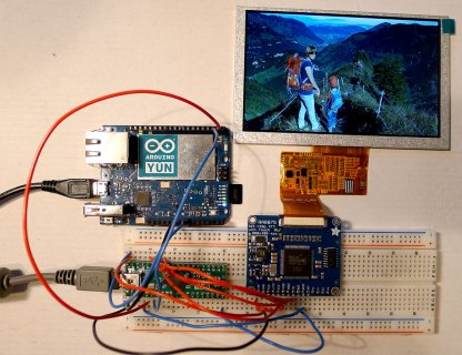

Displaying images from the internet on a TFT connected to a teensy++ using the bridge
Now I connected a 5" (800x480) TFT display http://www.adafruit.com/products/1680using a RA8875 driver board (http://www.adafruit.com/products/1590) by adafruit.
Teensy++ Pin | RA8875 pin
MISO/23      | MISO
MOSI/22      | MOSI
SCLK/21      | SCK
SS/20        | CS
D1/1         | INT
C7/17        | RST
Gnd          | GND
+5V          | VIN
Put images (BMP-format) at a location that the arduino yun can reach (e.g. on its own SD card that is available to it's webserver uhttp). In my example there are two files at the locations «/mnt/sda1/bilderrahmen/bilder/800x480/IMG_7862.bmp» and «/mnt/sda1/bilderrahmen/bilder/800x480/P1110713.bmp».
I uploaded the following sketch to the teensy++:

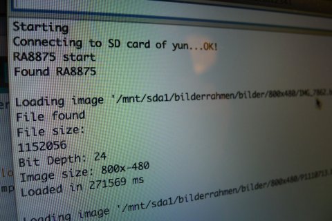

  Serial.print(F("Loading image '"));
  Serial.print(filename);
  Serial.println('\'');
  File bmpFile = FileSystem.open(filename);
  if (bmpFile == NULL) {
    Serial.println(F("File not found"));
    return;
  else {
    Serial.println(F("File found"));
  // Parse BMP header
  if(read16(&bmpFile) == 0x4D42) { // BMP signature
    Serial.println(F("File size: "));
    Serial.println(read32(&bmpFile));

Of course there is still the speed issue of the bridge (and if that were solved there remain still the only 16MHz of the teensy++):
271seconds (almost 5 minutes) to draw one image ... but we are working on that, aren't we? Looking forward!
Dani
On the side - I setup the image-delivering php-scripts on both arduino yun and raspberry pie: the AR9331 (400MHz) seems to be a lot quicker handing out websites and images than raspberry pi (700MHz). If possible, I'll stick with the yun. But porting the whole application to raspberry pi shouldn't be a problem - if we get a fast connection from a teensy to the apache of the raspberry pi. I'll document it with both systems.
I just got a teensy 3.1 and an ethernet shield; rpi is up and running; I'm looking forward to alternative ways to let the two systems communicate.
