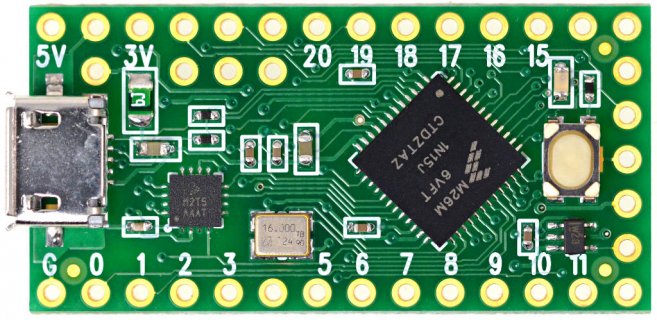

High-res Photo:
(click for full size)

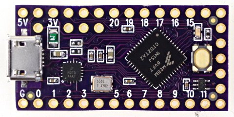

First Prototype:
As a special thanks to very active forum contributors and library authors, we're making an early, hand-soldered pre-production run. PJRC will send free Teensy-LC prototypes to these people:
cartere, christoph, Constantin, duff, el_supremo, embedded-creations, Experimentalist, Frank B, GremlinWrangler, Headroom, JBeale, jimmayhugh, johnnyfp, Jp3141, kriegsman, KurtE, linuxgeek, manitou, MichaelMeissner, MickMad, mortonkopf, mortonkopf, MuShoo, mxxx, Nantonos, nlecaude, nox771, onehorse, Pedvide, Pensive, pictographer, potatotron, robsoles, stevech, sumotoy, syso2342, teachop, tlb, turtle9er, whollender, WMXZ, Wozzy, xxxajk
We'll start with 9 purple prototypes, next week, and the rest with green prototypes in about 2 weeks. I'd like to invite everyone on this list to reply with something like "I have time to beta test now, please send me one of those first 9 boards", and if outside the USA, "I can pay the extra fees+duty UPS charges when delivering the package". Otherwise, we'll send you a green prototype in a couple weeks... still well before the regular production boards go on sale.

What are the double row of pins between pin 20 and 3V3? Oh pins 21-26, of course!
And what are the pins at the non-USB end, still DAC/PROGRAM/GND/3V3/VBAT?
And no pin pads on the bottom?
