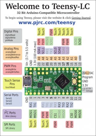

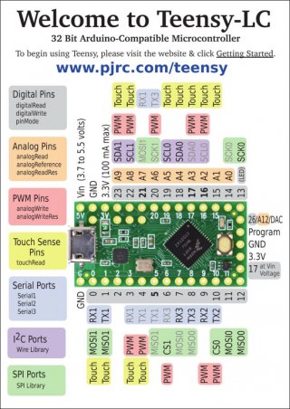

Also my built table could be wrong, but wondering about PWM on pin 21?
based on core_pins.h, i think your table is spot on, though you need to color pin 22 PWM (TPM0_CH0)

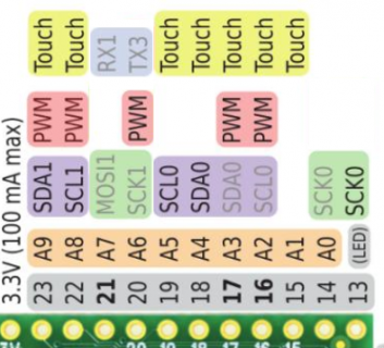

I agree pin 21 is NOT PWM , but 20 is PWM. here are channel assignments
#define FTM0_CH0_PIN 22
#define FTM0_CH1_PIN 23
#define FTM0_CH2_PIN 9
#define FTM0_CH3_PIN 10
#define FTM0_CH4_PIN 6
#define FTM0_CH5_PIN 20
#define FTM1_CH0_PIN 16
#define FTM1_CH1_PIN 17
#define FTM2_CH0_PIN 3
#define FTM2_CH1_PIN 4
Yes, good catch. Pin 21 was mislabled. The PWM was meant to be on pin 20. The DAC pin also has a copy-n-paste error of "17".
I'm planning to use much otherwise empty space on the back side to specify the per-pin current and interrupts. I hope to have a first draft tonight or early tomorrow.

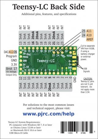

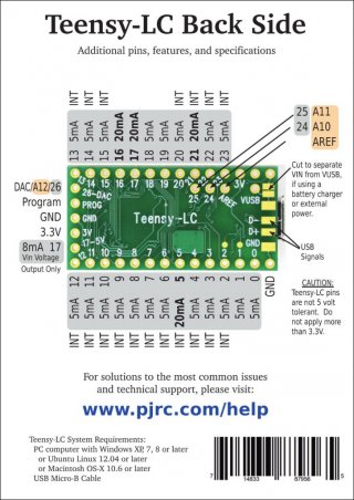

On 3.* cards, pin between Vin and 3.3v was marked as AGND
and shouldn't A12/DAC be 26 not 17?
the red dots for 20ma pins was nice addition as per Nantonos draft, though I guess your bold for 5,16,17,21 conveys that info (steganography)
what about AGND ?
your pin table in the first posting of this thread shows INT on pin 2, your card does not ...
#define CORE_INT2_PIN 2
otherwise, your back side looks fine.:(

This could make pin 17 on back harder to misinterpret, and the same has room on the front as well.
This arrangement would show fewer top row color jumps

I am not sure if it maters, but my spreadsheet I posted print out of, I think, pins 24, 25 on back also can be used for TX1, RX1?
Yes, they can. Maybe on the next rev of the card, I'll cram more stuff into that part.
Those lines with arrows are a problem though. Maybe there's a better way to show this?
It's going into this print shop today, so we'll have cards next week. Any more edits will need to go onto the next printing.
