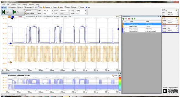

OK, I will try with the large resistor on SDA as you suggest, but I probably can not do it until Sunday night. Going to see my daughter get her graduate degree from Clemson on Friday! Thanks very much for all the help, I really appreciate it!
Matt
I have it working!
I tried the larger 10K resistor and that did not seem to change anything. I figured I would try the i2c_t3 library and after I converted my code to use that, it started working!
Thanks again for all the help across the board, I do not think I would have stuck with it if it wasn't for nox771 and Paul, many thanks!
Matt
Here is the trace of it receiving the data.

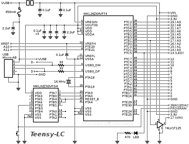

Is there any way to add an external reset button to an LC? Pressing the program button hangs the sketch, is that normal? I'm resorting to power cycling the board which seems crude.
The button on Teensy LC (and all Teensy boards) is for entering programming mode. It's *not* a reset button for restarting your program!
*YOU* can add a reset button. There should be a pad on the bottom. Just have your switch connected to it and GND. GND resets it.
The LC does not have a pad on the bottom for reset. Only the 3.1 and 3.2 have such a pad (and it is in a different location between the two). The only pads underneath the LC are the D-/D+ for USB, and the VUSB/VIN connection pad.
Maybe this was covered, but I can not seem to find the correct information.
I would like to use the Adafruit Trinket LiPo Back pack on my LC. It has a 3 connections - GND, Bat and Vin. It automatically switches from battery power to USB power when the USB on the trinket is plugged in. Would it be possible to do the same with the LC? I see that we have the 5V from the USB available, would connecting the other two pins to ground and Vin work?
I guess the real question is can I power the LC from a 3.7V batter using the Vin pin? It reads 3.7-5.5V, while the Vbat pin on the Teensy allows 3.3-16V.
The Adafruit Trinket Pro LiPo backpack won't fit directly on the LC, you would have to wire the 3 pins and place the backpack elsewhere. You would have to cut the trace between VIN and VUSB like you would have to for the 3.0/3.1/3.2 (https://forum.pjrc.com/threads/1922...ng-VIN-from-VUSB-Teensy-3-0?p=44024#post44024).
If you haven't bought the backpack, you might want to look into onehorse's custom board for the 3.0/3.1/3.2/LC. He has two boards, the original one would change smaller batteries, and his newer board charges larger batteries:
Beautiful,
Thanks, I have not yet ordered the backpack, but onehorse's boards may be the answer.
One followup - if I power the LC from a 3.7V battery connected to Vin and do not pug a USB in, should it startup and run correctly? I know if I want to have the USB and the batter in at the same time, I need to cut the trace. Then if I need to reprogram the LC, I need to keep the battery plugged in while I connect the USB.
Matt
You can power the Teensy from a 3.7 LiPo battery. With the LiPo battery charger soldered to the Teensy, even without the battery, the Teensy can be programmed from just the USB cable since the USB provides power to the charger chip, which supplies 4.2 V to Vin even in the absence of a battery. You'll get at most 100 mA this way but enough to program the Teensy.
