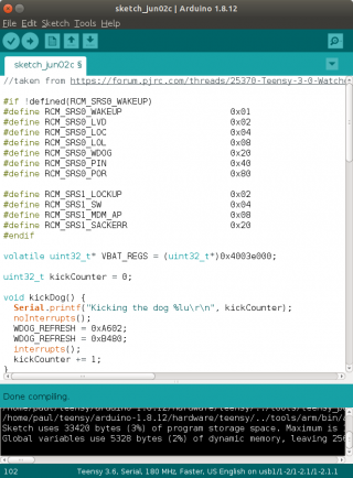

It compiles here without any errors on Linux.
This really should work on Windows too. My best guess is your Teensyduino install might be corrupted. Maybe Windows Defender or some other anti-virus interfered with the installer writing some of the files?
My Windows test laptop currently needs some work (not booting...) so I can't easily test this on Windows right now. Maybe Defragster or something else with Windows can confirm?
I just compiled on a different windows computer and the code compiled fine, must be an issue with the install on my end then.
