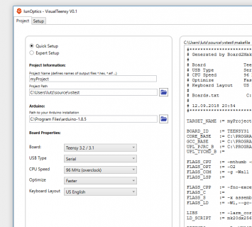

Inspired by this thread, I did a quick and pragmatic experiment compiling a blink sketch for Teensy 3.2 with Visual Code (Win10).
First of all: it works perfectly including Intellisense and all the convenience functions from a modern build environment. Build time is about 30s for a complete rebuild and below 1s if you only touch the sketch. Uploading with the teensy uploader as well as with TyCommander is included.
The place to start :: VisualCode projects for PJRC Teensy boards >> github::luni64/VisualTeensy
Here a screenshot of the environment:
Getting it going is quite simple and needs to be done only once.
You can compile / upload with CTRL + SHIFT + B (or via Tasks|Run Build Tasks) which gives you the following options:
Tested this with Arduino 1.8.5
Hope somebody can use this as a starter

VisualTeensy
VisualCode is a modern, open source code editor which can easily be used to compile and upload sketches for the PJRC Teensy Boards using VisualTeensy. VisualTeensy is a small Windows utility which fully automates the generation of Teensy projects for VisualCode. Precompiled binaries can be downloaded here.
