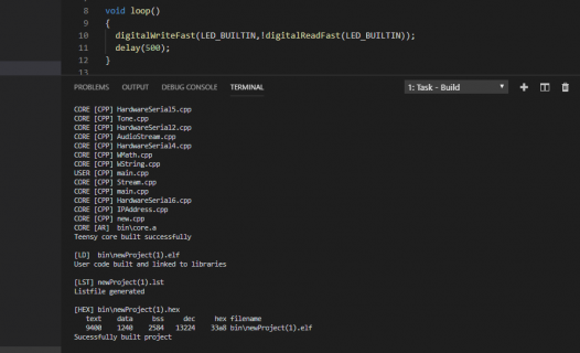

> Executing task: C:/Users/user2/Documents/VisualTeensy_V0.84/make.exe uploadTy -j -Otarget <
process_begin: CreateProcess(NULL, \tyCommanderC upload bin\visual_teensy_testproj.hex --autostart --wait --multi, ...) failed.
make (e=2): The system cannot find the file specified.
make: *** [makefile:154: uploadTy] Error 2
The terminal process terminated with exit code: 1

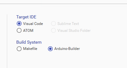

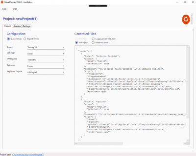

My Arduino installation is here:
D:\Dropbox\Arduino
So I edited VisualTeensy.exe.config as follows:
<setting name="arduinoBase" serializeAs="String">
<value>"D:\Dropbox\Arduino"<value/>
Since that edit, when trying to launch there is no error message but the application does not open either - nothing at all happens.
(Visual Studio Code is installed, as well as the C/C++ extension, and runs OK without VisualTeensy)
@luni: Pls can you point me to some instructions on how to set up the config file for non-standard installation locations, or advise on what else to try. Thanks.
