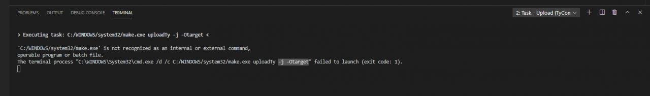

I followed all the steps but i cant compile i keep getting this error?

make.exe: *** [makefile:49: all] Error 1
The terminal process "C:\WINDOWS\System32\cmd.exe /d /c C:/Users/Lorenzo/Desktop/Arduinos/Teensy/VisualTeensy_v0_9_9_0/make.exe all " terminated with exit code: 2.
all:
$(BUILDER) $(FLAGS) -build-path=$(BUILD_PATH) -fqbn=$(FQBN) $(HARDWARE) $(TOOLS) $(LIBRARIES) $(SKETCH_NAME)
The makefile for *.ino builds is actually quite simple it just calls the builder with the give arguments. In case you are not familiar with makefile syntax, the $(XXX) parts are variables which are defined a few lines above.I suppose this error is the same due to some patch on this line that are not correct, but the other paths seems correct only the libraries are in a different location when using portable.

LIBRARIES += -libraries="C:\Users\Lorenzo\Desktop\Arduinos\Teensy\arduino-1.8.13 - TeensyDuino 1.53\arduino-1.8.13/portable/sketchbook/libraries"
Multiple libraries were found for "Ethernet.h"
Used: C:\Users\Lorenzo\Desktop\Arduinos\Teensy\arduino-1.8.13 - TeensyDuino 1.53\arduino-1.8.13\hardware\teensy\avr\libraries\Ethernet
Not used: C:\Users\Lorenzo\Desktop\Arduinos\Teensy\arduino-1.8.13 - TeensyDuino 1.53\arduino-1.8.13\libraries\Ethernet
Used: C:\Users\Lorenzo\Desktop\Arduinos\Teensy\arduino-1.8.13 - TeensyDuino 1.53\arduino-1.8.13\hardware\teensy\avr\libraries\SD
Not used: C:\Users\Lorenzo\Desktop\Arduinos\Teensy\arduino-1.8.13 - TeensyDuino 1.53\arduino-1.8.13\libraries\SD
Using library Ethernet at version 2.0.0 in folder: C:\Users\Lorenzo\Desktop\Arduinos\Teensy\arduino-1.8.13 - TeensyDuino 1.53\arduino-1.8.13\hardware\teensy\avr\libraries\Ethernet
Using library MIDI at version 5.0.2 in folder: C:\Users\Lorenzo\Desktop\Arduinos\Teensy\arduino-1.8.13 - TeensyDuino 1.53\arduino-1.8.13\hardware\teensy\avr\libraries\MIDI
Using library SPI at version 1.0 in folder: C:\Users\Lorenzo\Desktop\Arduinos\Teensy\arduino-1.8.13 - TeensyDuino 1.53\arduino-1.8.13\hardware\teensy\avr\libraries\SPI
Using library SD at version 1.2.2 in folder: C:\Users\Lorenzo\Desktop\Arduinos\Teensy\arduino-1.8.13 - TeensyDuino 1.53\arduino-1.8.13\hardware\teensy\avr\libraries\SD
Using library ArduinoJson at version 5.13.5 in folder: C:\Users\Lorenzo\Desktop\Arduinos\Teensy\arduino-1.8.13 - TeensyDuino 1.53\arduino-1.8.13\portable\sketchbook\libraries\ArduinoJson
Using library Artnet in folder: C:\Users\Lorenzo\Desktop\Arduinos\Teensy\arduino-1.8.13 - TeensyDuino 1.53\arduino-1.8.13\hardware\teensy\avr\libraries\Artnet (legacy)
Using library EEPROM at version 2.0 in folder: C:\Users\Lorenzo\Desktop\Arduinos\Teensy\arduino-1.8.13 - TeensyDuino 1.53\arduino-1.8.13\hardware\teensy\avr\libraries\EEPROM
"C:\\Users\\Lorenzo\\Desktop\\Arduinos\\Teensy\\arduino-1.8.13 - TeensyDuino 1.53\\arduino-1.8.13\\hardware\\teensy/../tools/arm/bin/arm-none-eabi-size" -A "C:\\Users\\Lorenzo\\AppData\\Local\\Temp\\arduino_build_470560/Mm2q_V2.27_MidiBeatClock.ino.elf"
Sketch uses 51956 bytes (4%) of program storage space. Maximum is 1048576 bytes.
Global variables use 8000 bytes (3%) of dynamic memory, leaving 254144 bytes for local variables. Maximum is 262144 bytes.
Used: C:\Users\Lorenzo\Desktop\Arduinos\Teensy\arduino-1.8.13 - TeensyDuino 1.53\arduino-1.8.13\libraries\Ethernet
Not used: C:\Users\Lorenzo\Desktop\Arduinos\Teensy\arduino-1.8.13 - TeensyDuino 1.53\arduino-1.8.13\hardware\teensy\avr\libraries\Ethernet
Used: C:\Users\Lorenzo\Desktop\Arduinos\Teensy\arduino-1.8.13 - TeensyDuino 1.53\arduino-1.8.13\libraries\SD
Not used: C:\Users\Lorenzo\Desktop\Arduinos\Teensy\arduino-1.8.13 - TeensyDuino 1.53\arduino-1.8.13\hardware\teensy\avr\libraries\SD
Using library Ethernet at version 2.0.0 in folder: C:\Users\Lorenzo\Desktop\Arduinos\Teensy\arduino-1.8.13 - TeensyDuino 1.53\arduino-1.8.13\libraries\Ethernet
Using library SD at version 1.2.4 in folder: C:\Users\Lorenzo\Desktop\Arduinos\Teensy\arduino-1.8.13 - TeensyDuino 1.53\arduino-1.8.13\libraries\SD
exit status 1
C:\Users\Lorenzo\Desktop\test_visualteensy\Mm2q_V2.27_MidiBeatClock\Mm2q_V2.27_MidiBeatClock\Mm2q_V2.27_MidiBeatClock.ino:109:20: error: 'BUILTIN_SDCARD' was not declared in this scope
#define SS_SD_CARD BUILTIN_SDCARD // using SD card in the main board
C:\Users\Lorenzo\Desktop\test_visualteensy\Mm2q_V2.27_MidiBeatClock\Mm2q_V2.27_MidiBeatClock\SD_Read.ino:4:17: note: in expansion of macro 'SS_SD_CARD'
if (!SD.begin(SS_SD_CARD)) {
LIBRARIES := -libraries="C:\Users\Lorenzo\Documents\Arduino/libraries"
LIBRARIES += -libraries="C:\Users\Lorenzo\Desktop\Arduinos\Teensy\arduino-1.8.13 - TeensyDuino 1.53\arduino-1.8.13/hardware/teensy/avr/libraries"
#LIBRARIES += -libraries="C:\Users\Lorenzo\Desktop\Arduinos\Teensy\arduino-1.8.13 - TeensyDuino 1.53\arduino-1.8.13/libraries"
-built-in-libraries C:\Users\lutz\Documents\arduino-1.8.12-Teensyduino153\libraries
