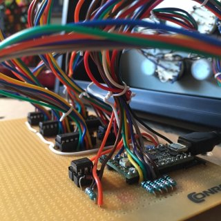

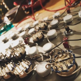

Hi, just wanted to share this project that I completed a while ago. This is my first Teensy based project and I've only completed a couple of preprinted DIY eurorack modules before so I'm quite happy with how it turned out
It's a MIDI controller for the Roland MKS-50. The synthesizer has very limited controlling abilities out of the box and depends on having an external programmer like the PG-300 to use it beyond its presets. Since it's quite old, 1987 it uses its own sysex implementation instead of ordinary cc messages for most of it's parameters, so I decided to make my own implementation.

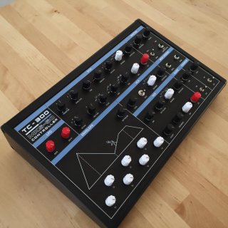

Say hello to the TC-300!

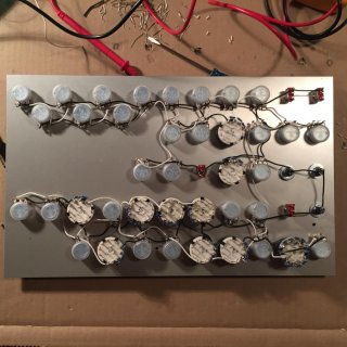

It has 46 knobs and switches to provide control over all the parameters you are likely to use. Here's a list of what you can control:

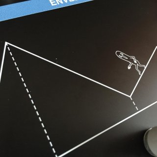

When designing the panel, I took inspiration from the Roland Juno synths. I also like colour coding of the knobs indicating what function they have (LFO & envelope). Together with the distinct sections and the large envelope sketch, I think I managed to make the interface very intuitive.

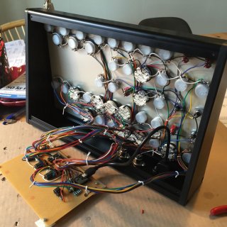

The panel design was sent to Takachi Enclosure for inkjet printing and punch pressing on one their aluminum cases.
