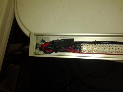

Can you post a photo of how it's wired up?
Generally the best strategy is locating the power supplies close to the LEDs, connected with large and short wires running directly to the LEDs. It's best for the data plus ground to run from the Teensy to the LEDs, with the grounds meeting at or near the LEDs.
Long strips, where over 60 LEDs is entering "long" territory, often need power applied at both ends.
One simple test you can do is turn all the LEDs on to maximum brightness. Then use a voltmeter to measure the 5V power at various locations, like both ends of each LED strip, and in the middle if you access the strip (eg, not encased in a clear rubber tube). You're looking for any location that drops more than about 0.3 volts from whatever the power supply actually puts out.

Hi guys,
Thanks for the responses, I think I'm getting somewhere.
Paul, I posted some pictures of how everything is currently wired up. I didn't take a picture of the middle of the strip, but there is a feed there too. When I put my meter on the power "rails" I get 4.9V at the feed-end and about 4.6V at the far end with everything white (and also most no flicker). In the blue CAT5 I have the green pair as ground, the orange is 5V to the bread board, blue/white is data and blue is also a ground, I am not using the brown pair.
tetsuo, when I test at full white there is little to no flicker; when I "dim" white with my DMX console I get various brightness flickers and different color flickers. My signals going out look horrible compared to what you have, there are "dips" in the highs and other "noise".
I'm not sure I follow correctly - are you using CAT5 to carry power to the strip? I can't see how you're getting 4.9V at the strip if that's the case (maybe at low brightness levels, but I'd expect that to drop well below 4V at full-strip-white).
Also, where is your resistor for the data? For data over CAT5, you should have a 100 Ohm resistor as close to the output pin of the HCT245 as possible.
For whatever it's worth, my setup is:
4AWG wire for a set of 504 LEDs, with the final 12"-24" as a pair of 16AWG to each 42-LED segment. (total: 6 pairs of 4AWG breaking out into 72 pairs of 16AWG). The CAT-6 carries only data. with half of each pair being connected to both GND at the strip and GND on the teensy. The 100 Ohm resistors are one protoboard hole away from the 74HCT245N outputs . I really MUST get some pictures... will try to do so tonight.
Ahh - wait, I see. You're running power to the connector for the strip, and then FROM that connector back to the teensy? I'm not sure what the pros/cons of such a layout would be, but it's certainly different than what I've seen elsewhere :)
One last thing! In addition to needing a 100 Ohm resistor near the transceiver, you probably need one where you're transitioning from CAT5 to whatever stranded copper you're using for the last 12+ inches. I mis-measured on one of my CAT6 cuts and when I tried to extend it a few extra inches w/ some extra 18AWG speaker wire and the signal quality went south. The extra 100-Ohm resistor at the transition fixed it right up!
Hi testsuo,
The CAT5 only powers from the connector to the bread board and carries data from the bread board to the connector. I need to be able to easily move this thing (to some degree) so I had to use something, that XLR plug is rated at like 16A per pin.
I tend to reinvent the wheel whenever possible...
Ok.
For the sake of troubleshooting, could you try a simple hard-wired test? Even though it's totally impractical for how you need to deploy this project, the idea isn't to make a final solution but instead to just try learning more about why it's flickering and possible solutions.
I'd suggest removing the cable and connectors. Put the LEDs on the table with the power supply. Run those heavy red and black wires directly into the power supply, with only a few inches of wire running between them. During this test, run just 1 twisted pair of the CAT5 cable between Teensy and the LEDs, for only signal and ground. Connect the grounds at the LEDs, or as close to the LEDs as reasonably possible (eg, do not wire the CAT5 ground to the power supply, get it connected at the LEDs). During this test, the Teensy will obviously need its own power. Best to use a battery or non-grounded power supply like a wall wart.
Again, this idea is only just for troubleshooting, to see if this connection style can solve the flickering. Even though you can't use it that way, at least finding some connection that eliminates the flickering will give you a solid starting point to work towards a wiring style that can meet your needs.
