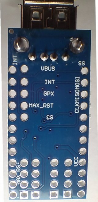

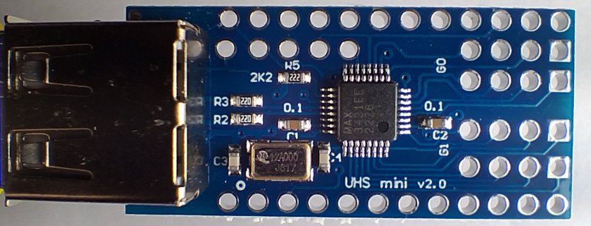

Has anyone succeeded in connecting a Chinese mini USB host to a Teensy or other board and had a program process USB input all the way to its intended output on the TX line? If so can you post a complete wiring diagram with pin functions? And the Host versions? I ask because I have read many posts on this and other forums on this subject but none claiming success and including complete methods. I would like to test a Chinese clone mini host claiming to be v2.0 (see photos included) and looking exactly like the one from DuinoFun UHS mini v2.0.
I’ve seen many partial or ambiguous wiring suggestions as well as claims of silkscreen labeling errors and other conflicting claims. I, and perhaps others would appreciate clear and accurate information to complete this project. Thanks for any and all assistance. Aaron

I haven't tested those old host shields with newer Teensy models, but I believe they should work if you follow the instructions on that page, but connect MOSI, MISO, SCK to pins 11, 12, 13. See Teensy 4.0 pinout for details.
How to power that USB host shield is complicated. It wants 3.3V power. You can power it with Teensy's 3.3V power pin, but there are 2 drawbacks because that shield is poorly designed from a power perspective.
First problem, the 3.3V power will also be sent to the USB host port to power up whatever USB device you have. USB spec says host ports should provide 5 volts and allows a range from 4.4V to 5.25V. Some devices can work with only 3.3V power, but many can not.
Second problem, hotplugging USB devices can cause a power brownout condition that reboots Teensy. The proper solution uses a current limiting chip and larger capacitor, like we have on Teensy 4.1 and Teensy 3.6. Without those, you will almost certainly have problems when hotplugging. Best to make sure the USB device is plugged in before you power up, and only unplug and plug in something else while power is off.
USB spec also requires current limiting to protect your hardware, and prevent cable melting or burning overcurrent if your power supply is strong enough to deliver many amps. This shield meets none of those requirements. Probably not a big deal for a hobby project, but something to keep in mind if your project gets wider usage.
Older version of this shield had jumper pads you could cut apart, so the MAX3412E part could be powered by 3.3V and the USB host connector could get separate 5 volt power. From your photo, looks like the design is nearly identical but with those jumper pads removed.
Hi Paul, Thanks for your comments and the links you have included. Have you succeeded with any of these clone hosts? I ask because there are so many complaints posted without success. The hosts I have now "look" like the original circuits@home v2.0 and have none of the obvious errors or defects reported. (See attached for example). But one never knows.
So I'm just looking for "gotchas" or other traps or time wasters.
Yes, I'm familiar with the power issue of 3.3v vs 5v and current demands of some devices. Fortunately it's easy to cut tracks on these boards. And normally feed boards with separate well filtered power supplies, 150mF & .01mF. And my designs don't normally need hotplugging. And yes, I well aware of USB specs. I'm a retired EE with microprocessor design going back to the 8048.

I only ever used 2 boards with MAX3412E. One is that board you can see in the photos, which looks very similar to yours.
The other is a host shield I designed but we never brought it to market. You can see it on the leftover stuff sale page. Scroll down to "USB Host Shield That Never Was (for Teensy 2.0)".
I looked in collection of old Arduino library test hardware. This is literally everything I have left for MAX3412E. I probably did test it at some point with Teensy 3.0 or Teensy 3.2, since the left board has 14 pin sockets and the wires underneath look like they're connected to the pins needed on newer Teensy. But the reality is I mostly played with MAX3412E long ago in the days of Teensy 2.0. I really haven't done much with it since then.

This is the closest I found - not sure the site is working anymore
I did some searching and found this. Can't be 100% certain this is really it. Nearly all the old websites have become 404 or other errors. But this PDF looks pretty likely to be the original schematic.

Personally I have never had much luck with the knock offs that I bought. I have one of the original Circuits at home boards and they always worked. But as Paul said if you are using a Teensy 4.1 use the builtin usb host not a shield. Only time I use them now is if I am testing on a Arduino style board like the uno's etc.
