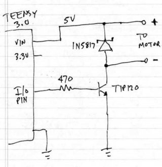

I'd use a TIP120 transistor, 1N5817 diode, and 470 ohm resistor, like this:

When you turn off the current to the motor, energy will be stored in the magnetic field inside the winding and iron. Without the diode, to provide a path for current to temporarily continue conducting with this energy dissipates (into a tiny amount of heating in the diode), it would create a high voltage spike that can easily destroy the transistor and maybe even Teensy. Always connect the diode in parallel with the motor, with the cathode side (the side with the stripe) facing towards positive.
Thanks for the diagram and the diode hint, given that I am new to this, such advice is very valuable for me.
I assume I can use the same diagram (adjusting for a different power source) to control a 12V motor, am I correct?
Yes, this same circuit works for 12 volts, except of course you would not connect 12 volts to VIN. Connect the 12 volts only to the motor positive and the diode's cathode.
Of course, it also depends on the ground or negative wire of the 12 volt supply connecting to the ground on Teensy 3.0.
