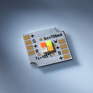

Basically I'd like to drive these 4W (1W per channel) current-driven LEDs:
https://www.lumitronix.com/en_gb/smartarray-q4-led-module-4w-rgbw-4000k-cri-90-32454.html
What surprised me was that they only require 3V, and then I learned that with these types of high intensity LEDs, the voltage is not important, but the (consistency of the) current is.

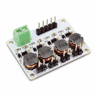

I looked a long time for a suitable LED driver, and ended up buying one of these, which can take in 5-36V and provide a stable current.
https://store.open-electronics.org/colibri
Which also came with a long article explaining the usage of high intensity LEDs
https://www.open-electronics.org/colibri-driver-for-rgbw-leds/

- Colibri 4 channel PWM controlled LED driver
