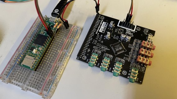

Hi, @houtson, I've tried to connect to the CS42448 board with and without pull-up resistors (two 9.7k ohm, I don't have 4.7k atm) between 3.3v and SDA, 3.3V and SCL, still couldn't talk to the CS42448, any idea why? thank you so much.

9.7K is too high, 3k3 will be fine with 3.3V. The CS42448 shows 2k resistors, but that caters for voltages down to 1.8V.
Now I don't have 4.7k or 3.3k at my hand, tried 1k, also didn't work.... but why I don't see people use pull-up resistor here and it still works? I thought there's inbuilt pull-up resistors.
The inbuilt pull up resistors are in the order of 10k.
That is too high and the code has to turn them on.
1K is likely too low.
Try 2 (or 3) 9.7k resistors in parallel (=4.85k (or =3.23k)).
Please don't post the same question on multiple threads.
As far as I can see you've missed setting the CS42448 address by wiring the address setting pins AD0 and AD1. There's a long discussion, with relevant information starting at this post. My solution was to wire them on the bare pads left by IC1 not being fitted; I also put a link / zero-ohm resistor on R20 which gives you 3.3V to IC1 pad 2 - you don't need this if you're only going to wire the pins to ground for a single board.
As BriComp states, you do of course need the pull-ups as well.

It seems you flip the SCL and SDA on the teensy,the red wire should be on the right on teensy,if i'm not :unsure: wrong
Hey! so sorry I found this thread is more related to my question but i couldn't delete my post in another thread. (I also just realized I post it to a wrong page).
I did some reading and I think it's I didn't wiring the address. (yes I found I swapped the SDA and SCL on Teensy but it still didn't work after I flip it back). So, for single CS42448 board with teensy 4.1, I guess I need to define my board by any of the 4 cases below:
AD0 to Gnd and AD1 to Gnd => address 0x48
AD0 to Gnd and AD1 to 3.3V => address 0x4A
AD0 to 3.3V and AD1 to Gnd => address 0x49
AD0 to 3.3V and AD1 to 3.3V => address 0x4B
but how do I declare the address in the arduino code? :D

Please please please can everyone stop parroting that pull-ups are not needed on SCL and SDA. They are. You may possibly get away with it in a lash-up, or if it so happens there are other things connected which provide the pull-ups and you have omitted to tell us about. But giving incorrect advice to the inexperienced, and on a forum that will be read for years, is just a recipe for causing people to waste a lot of time in the future wondering why their hardware isn't working.
Pull-ups are part of the I²C specification. Fit them.
Also, specifically for the CS42448, you must wire AD0/AD1 - the data sheet tells you to do so. If you don't you risk a glitch on AD0 putting the CS42448 into SPI mode rather than I²C, and you will not be able to set it up.

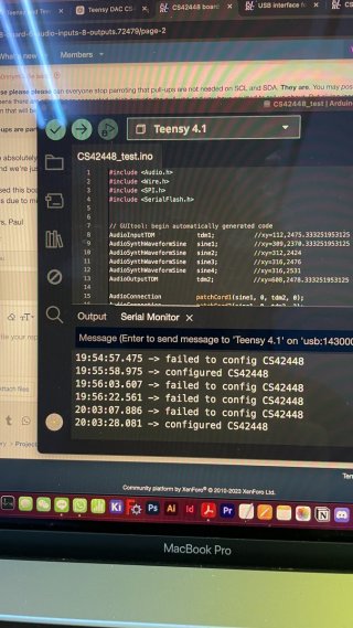

Ok, so I think I've tried both ways and they all didn't work, and since I am only debugging the I2C scanner, now I only leave I2C cables connected (btw i found my CS42448 chip is cold now, before it's pretty hot with other wires connected):
1. Bare board (AD0 and AD1 are not connected to GND, no pull-up resistors).
2. Wired board (AD0 and AD1 are connected to GND, two 2.2k resistors in between 3.3V/SCL, 3.3V/SDA).
The "configured CS42448" texts were only shown when I unplug the VCC wire from 5V pin to 3.3V pin of Teensy 4.1, but there's no sinwave heard in my earphone so I guess it's just a glitch. I bought these board with like 15 dollars from Taobao.

Do you switch off and on, the teensy,to see really if the cs42448 is configured or not in the monitor?
I do that two or three times,to be sure of the stable situation.
So if the cs42448 is configured it's ok with the I2C,now the trouble can come from the TDM wiring,

It got configured well after I added two 2.2k pull-up resistors to 3.3V as @h4yn0nnym0u52 suggested here. I will go to the related thread for the rest of the work, sorry for the noise & thanks for all the helps!
