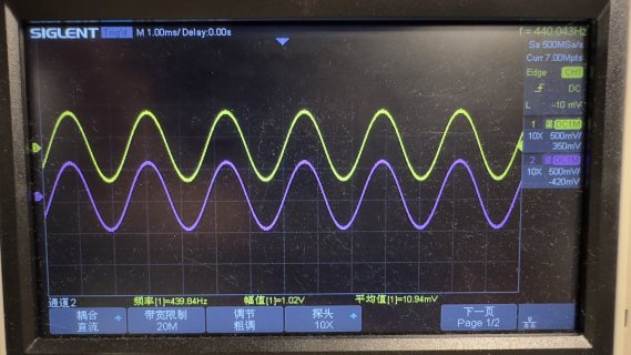

Hi Houston
I'm using the same board. But I just can't get the signal through TDM input. The input signal of TDM is two identical sine wave from a function generator which Vpp is 1v. I have tried using library built-in sine wave sending toTDM output and I can see it. So I guess the problem is at ADC. btw the ADC mode I'm using now is single-ended.
How have you connected the sig-gen output to the ADC inputs? Ideally, provide a schematic, not just a description in words...

the schematics is like this.
A1IN+ ---> 3.5 Right ---> Sine wave (yellow in scope)
A2IN+ ---> 3.5 Left ---> Sine wave (pink in scope)
GND ---> 3.5 GND ---> cable shield

Ah, OK, paying proper attention now ... it's that board. You can find some information on how to set it up to work with the Teensy at this post - it's possibly worth skimming the whole thread.
One thing that occurs to me is the clock wiring. The CS42448 has separate BCLK and LRCLK pins for the DAC and ADC, which need to be wired - that's a reasonably unusual thing to need to do. Connect BCLK_OUT0 to BCLK_IN0, and LRCLK_OUT0 to LRCLK_IN0 (these are board connector pin names, not chip). You'll see I did it with very fine wires to the resistors, but as long as the wires are short enough you should be OK.
It sounds like you have AD0 and AD1 wired, and pull-ups on SCL and SDA, since you have the DAC working.

yeah the board connector pin name and chip is confusing. After reading couple threads about CS42448 and its data sheet. I'm sure the DAC is running normal. The clock looks normal (MCLK_22.58 MHz / LRCLK 11.29 MHz / BCLK 44.1 KHz). Trying to figure out is there anything missing.
The whole wire I have connected is
Teensy 4.1CS42448__board connector pin
5V5V
GNDGND
MCLK1 (pin23)MCLK_OUT
LRCLK1 (pin20)LRCLK_O0 / LRCLK_IN0
BLCK1 (pin21)BLCK_O0 / BCLK_IN0
SCL (pin19)SCL (w 2.2K ohm to 3.3V)
SDA (pin18)SDA (same as SCL)
OUT1A (pin7)SD_OUT0
IN1 (pin8)SD_IN0
AD0 / AD1 to GND (address 0x48)
