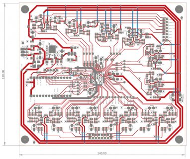

The CS42448 developer boards seemed to be well documented and I decided to make a layout based on it. From my previous analogue projects I've 8 channel buffers and amplifier modules for further signal conditioning.
When I've found this thread a couple of days ago, I thought that I could share my layout and discuss it here, if someone is interested in.
I still need to double check some footprints and component availability as well as the Teensy connections and the analog and digital ground section. I'm thinking about making a slit in the ground section to separate the digital part. But I'm not that deep into implementing proper grounding in mixed signal designs.
There are already some very nice and thoughtful CS42448/Teensy layouts out here, which consider different applications and, most important, these designs are very elegant and usable. Whereas the layout I did according to the CS42448 developer board is quite big and has a high part count and includes even 402 smd packages. I guess it's recommendable to use a stencil and reflow ofen to build this board.
Nevertheless, it could be interesting for some people.
Those long loopy rails look like big inductors or antennas to me ...
My experience is that high-quality audio benefits from four-layer boards, and may benefit from two-sided component mounts.
Four-layers isn't that much more expensive than two-layer (I mean, the PCB is twice the cost, but the PCB isn't the biggest part of the BOM.)
Double-sided surface mount is tough for home-solderers, but if you use a place like Macrofab, they charge no extra for double-sided stuffing.
Anyway, so, with a four-layer board, you'll want to use a wide ground layer right underneath the signals, and a wide power layer below that.
You may even want to route all the components with via-in-pad, with a layer order of something like GND+pads, signals, power-and-signals, GND.
Also: film capacitors, thin film (or even metal foil) resistors. Yes, it increases BOM cost. Yes, it's worth it.
Just to add to the layout discussion, small component spacing is a pain for home builders but also fabricators.
Keeping the analog and digital ground planes separate, and joining them up under the CS42448 is best practice. On my board I've put a separate ground plane under the Teensy and stretching to the CS chip, particularly to avoid audio return (ground) currents from travelling through the noisy digital groundplane around the Teensy.
As @jwatte noted, long loopy rails act like inductors, so need to be properly bypassed to avoid becoming noise transmitters. It's unclear from your image whether this is being done. 100nF X7R every 2-3 linear inches / at each chip is about right.
Make sure you specify COG capacitors (or electrolytics) for any audio capacitances - particularly those across the AIN+/- inputs. X7Rs, which are great for bypassing, have non-linear V-C coefficients and can add significantly to overall distortion.
Best wishes for your board.
That's not really feasible for the main inline DC blocking caps and bulk capacitance, though. Hence, the fall-back to film!
Even there, a 4.7 uF capacitor is going to be 7.5x7.5 millimeter of board space, 20 mm+ tall, and cost you a buck fifty, each.
High quality audio is expensive, compared to digital.
Thank you very much for your feedback. Much appreciated!
Those comments make sense and I'll consider them.
When I'm continuing on this project I'll open up a separate thread.
