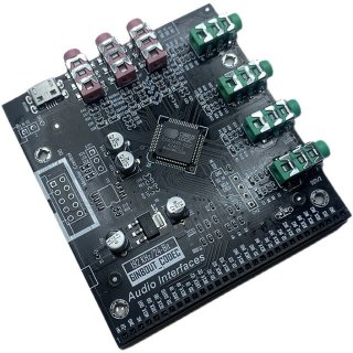

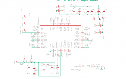

Hi
Just got my CS42448 board back and soldered it all together, just trying to see if it works at all, not sure how to hook it up via the audio design tool.
Usually with SGTL, you don't output the audio through there, there's an I2S object, but this codec uses TDM. If I wanted to just send a sine wave out of one output on the CS codec how would I hook it up?
This is my attempt, in picture attached Screen Shot 2022-02-11 at 17.21.47.png
I did find somewhere that a zero bit may need to be sent, or something to kick start to the process.
Any ideas or kicks in the right direction would be really helpful
Seems to work fine over USB, but analog section input and output is not happening.
Checked whether .enable returns a true value and seems fine. Sinewave via USB works fine, so works as a sound card with two channels.
I've tried the "write(CS42448_Functional_Mode, 0xF4 | 0x01 );" fix and nothing happening there.
Measured VQ and seems fine @5v.

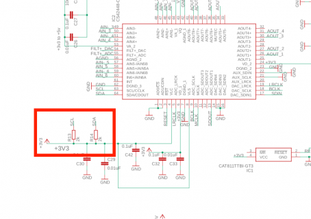

here's my schematic:
Not sure what to try next, I know there's a few people that have got the CS42448 working around here, seemed to have exhausted the tips or suggestions on what to test.

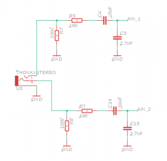

Input section:

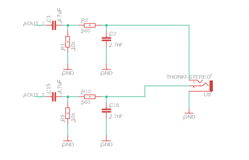

Output:

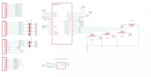

Teensy part:

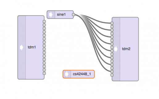

// Advanced Microcontroller-based Audio Workshop
// http://www.pjrc.com/store/audio_tutorial_kit.html
// https://hackaday.io/project/8292-microcontroller-audio-workshop-had-supercon-2015
// Part 2-8: Oscillators
// copy the Design Tool code here
#include <SerialFlash.h>
//AudioOutputUSB           usb1;
AudioInputTDM            tdm1;           //xy=125.44445419311523,183.55555725097656
AudioSynthWaveformSine   sine1;          //xy=235.5555534362793,59.99999237060547
AudioOutputTDM           tdm2;           //xy=480.55558013916016,189.88887786865234
AudioConnection          patchCord6(sine1, 0, tdm2, 0);
AudioConnection          patchCord7(sine1, 0, tdm2, 2);
AudioControlCS42448      cs42448_1;
  //Serial.begin(9600);
  AudioMemory(80);
  cs42448_1.enable();
  if (cs42448_1.enable() == true)
    Serial.println("is ok");
  cs42448_1.volume(1.0);
  sine1.frequency(200);
  sine1.amplitude(0.9);

I think it might be the board itself, and my assumptions about ground/analog ground might be messing everything up.
Thanks for the reply, I've kinda lost quite a bit of momentum with getting the CS working, think I ruined at least one of the chips learning how to solder QFP's.
This is the schematic and boards in it's current state: https://github.com/braindamp/CS42248
I'm sure it must by the analog/digital ground, I thought I could get away with having one big copper pour for ground as the dig/analog sections of the chip are separated.
I have a few boards happy to send in the post to anyone interested, i'm in UK but don't think it'll be too expensive sticking a board across the pond if someone's interested from over there. I do feel a little defeated by this project, so any help is welcome
Why are you calling enable() twice on the cs42448_1 ?
Also this looks suspicious:
  // use the knobs to adjust parameters
  float knob1 = (float)analogRead(A2) / 1023.0;
  //Serial.println(knob1);
  sine1.frequency(knob1 * 1500 + 50);
as it updates sine1.frequecy perhaps 100000's of times a second.

ok so I've changed to:
  AudioMemory(80);
  static unsigned long check_knob_time = 0 ;
  if (millis() - check_knob_time >= 50)  // limit changes to every 50ms
    check_knob_time += 50 ;
I get an "is ok" in the serial monitor, but no audio. I've must have done something wrong in building the boards schematics/layout or killed the chip.
I guess double check every connection and all the register configuration options - I note the datasheet shows 2k pullup resistors
on the I2C lines which your schematic lacks, that might be important as 10k would be expected normally.
there is one more thing you could test,
the voltage in the VQ pin has to be about 2.5v, if not, the codec will give no sound.
You can check the voltage on the capacitors connected to that pin which is easier than placing the prove in the pin itself,
or you can try the fix directly by adding a line of code on control_cs42448.cpp
hope it helps
ok excellent, thank you so much for the advice. I've got the 2k pull ups on the board with the codec on Screen Shot 2022-03-15 at 14.11.14.png
Maybe I have them on the wrong board, are they better placed near the teensy?
I'll go through all the connections with a fine tooth comb, the one main thing I did different was use four layers, and have the middle layers as 5v and 3v3. and the bottom layer full ground, and traces on the top.
And I ignored the part about using a separate analog ground/digital ground. If they're at diff voltage potentials, I may have a big problem, but I thought Gnd for digi and analog were both 0v so there wouldn't be a problem

voltage is giving 2.5, but I did install the chip badly at one stage and was getting 5v I think. That might have destroyed the chip.
"or you can try the fix directly by adding a line of code on control_cs42448.cpp"
adding a line of code? I think I have changed the Control file to the suggested changes:
bool AudioControlCS42448::enable(void)
	Wire.begin();
	// TODO: wait for reset signal high??
	if (!write(CS42448_Power_Control, 0xFF)) return false; // power down
	if (!write(CS42448_Functional_Mode, default_config, sizeof(default_config))) return false;
	if (!write(CS42448_Power_Control, 0)) return false; // power up
	return true;
Is there anything else in that file I should have a look at?
And thank you both so much, a fresh pair of eyes on this is really appreciated
