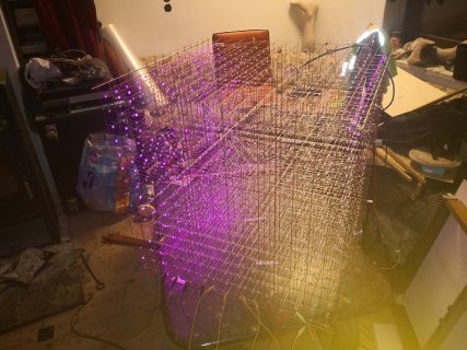

I now have my 15x15x15 cube almost finished. and wanted to use the octows2811 libery. 2 levels of 225 LED each on one channel. Unfortunately I have to realize that the number of LEDs per strand is too high. From the 300th LED onwards there are many errors. So I either need 2 Octos or would have to install a 16-channel version (actually 15 of course). Unfortunately, my programming knowledge reaches its limits.I'm looking for a good sketch or examples.
i use a teensy 4.1
thanks and sorry for my bad english
I tried around a bit more. If I turn the brightness down, the errors occur. If it were the other way around, I would say the power supply is too small. In the basic test it works perfectly. It also appears in the same place in every strand. That's why I don't think it's due to faulty solder joints.
I just swapped the strands. Now the one that made the mistakes before works and vice versa.

How are you routing signal ground?
the grounds are all connected to each other.the vertical wires alternate + and -.The data inputs are connected via Ethernet cable, 4x signals each, the white ones are also on ground. I also connected the ground from the octoshield
I would also assume at first it could be a problem with power or ground.
The data signals are generated in each LED as a new fresh signal for the following LED. If the problem starts at a certain LED it could be that there is one faulty. Looking at the impressivley huge setup I would think it is not an easy option to solder the data line from one LED out and bridge it to the next to check?
So the data signal and signal ground aren't run alongside each other? That could lead to large loop areas and lots of stray inductance on the digital signal.
OK, but the problem only appears after about 2/3 of the strand's length. The 8th is only half the length and doesn't cause any problems. So my original question comes back. So I need 15 channels (The next option would be 25) instead of 8... how could this be realized?
I've made several more attempts now...
- intentionally degraded the data line... same result, not worse
- LED numbers reduced in software... no errors
- LED numbers reduced in hardware... no errors
- clock rate changed (+ and -).. same result
- fade and delay time reduced... visually better of course, but not the solution
Tomorrow I'll add some more voltage bypasses, but I don't think it will help. This is more about the statics...
Due to the architecture of the cube, I cannot send the data ground in parallel (inside).
I also build a 9x cube (729LED) with the same architecture, which only has one data input, controlled with Arduino Mega, I have no glitches at all...
it was so easy...
parallel output
15 channels each with 225 LEDs..
no more problems
The WS2811 LED is too slow and the Octows is the next brake With Teensy 4.1 I have enough pins and speed
I would also like to mention that between Teensy and Cube, now that it works, I have 4 10m long LAN cables for data transfer... and it still works. where I found one (out of about 10,000 8) ) bad solder joints and two bad led (all on the outside :) )...now.
For my programming attempts it's easier this way... One of the next steps is to activate the Ethernet interface or via ESP and WiFi. Unfortunately that doesn't work so far... In the end I want to control the cube via art-net and integrate it into my light show
Thank you for your answers..and I hope my questions help others too
