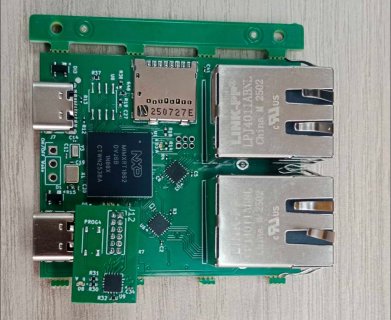

This is my board I want to use 2 Ethernet ports, the bootloader chip is connected to J12

Let's focus on your boards which have the 3 blink error. Normally 3 blink means the flash chip is not soldered or an incompatible part.
I see this empty place on your photo. Is this where the flash chip should be?

This is an old picture, I've already mount a PJRC flash. The current problem are with 10 blinks and 1 blink.

Since we know the blink means USB problem, first part of the schematic I viewed was this:
I don't understand this part for J6. It has only 7 pins.
The USB connector in your photo appears to have 12 pins.
2 other minor possible issues.
GPIO_AD_B0_05 (BOOT_MODE_1) is supposed to connect to GND. But it is wired to JP1, uncertain how JP1 actually connects.
GPIO_SD_B1_05 is supposed to be left unconnected.
