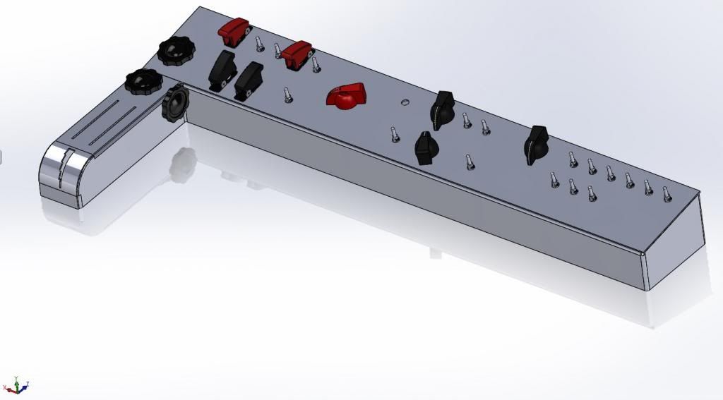

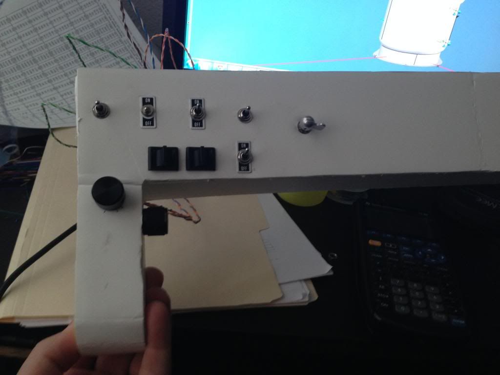

I am working on my first teensy project. My goal is to make a switch panel for a flight simulator that works just like a joystick with a lot of buttons. The joystick feature that comes with the Teensyduino that I am currently using has 32 buttons, 6 axes, and 1 hat switch. This seems like a lot but I need more buttons. My question is this: Is there a way to customize the joystick so it has the maximum possible buttons and six separate axes? I don't need the hat switch at all. So far I have tried to work around this issue by treating the hat as eight different buttons but this has been causing some issues. By the way if it is possible to make a custom joystick driver or whatever for the teensy++ 2.0, does anyone know how many buttons I can make it have if I just want buttons and six separate axes?
Thank you for any help.

Thanks you for all the info! I think the real limit will be the number of I/O pins I have on my Teensy ++ 2.0 board. then again I guess I could set up some logic such as if button 1 and 2 are low (or some some arbitrary combination) flash button 3... and so on. Dange, I hope I can follow your guys instructions! I was thinking I might have to use two or more teensy ++ boards. The simulator I am going to be using this project for primarily will be DCS: P-51. I am aware that there is some kind of maximum number of buttons that either windows or the simulator have but I seem to think it was somewhere around 128 as well.
Here is a incomplete render of the panel I am trying to make. It doesn't look like I need a lot of button but most of the toggle switches have 3 positions (each one requires a separate button) and some of the rotary switches have up to 5 positions. If the maximum upper limit of buttons is really around 128 and I could use the logic I mentioned up earlier I might expand my panel to include even more functions.
P.S. I work for a manufacturing company which has several laser cutting tables as well as sheet metal forming tools and spot welders. Eventually, I will be making the panel out of stainless sheet metal but for now I am just using poster board. I have done a little more then what this next picture shows but it will give you an idea of what I am doing, in case you are interested.
I'll keep this tread updated as I make progress, which might be slow some times since we just added another addition to our family and my time is a little strapped at the moment.
