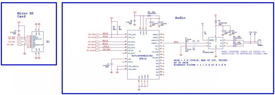

Please look at the following schematics and let me know if I did something wrong. I bought MINILAN54 chips for 6 demo boards, had the factory solder everything up, and now I can not get the first test PCB to show up as a USB device or comm port like normal. Breadboard version with Teensy 3.1 works great of course. Powering with 5V and 3.3V linear regulators and LiPo 7.4V. Any ideas?
Note schematic out of date: bootloader chip P3.2 actually connects to RESET_B, not RESET to RESET_B as shown
PCB basic parts:
  • MK20DX256 and MINILAN54 (teensy 3.1 and bootloader)
  • SGTL5000 and microSD card (teensy 3.1 audio board)
  • amplifier circuit
  • USB port
  • 2 bluetooth chips
  • several GPI pins blanked out, should be irrelevant
Ideas?
Wrong crystal oscillator CSTCE16MOV53-R0
--Crystal is close by and has only ground plane directly under, no traces too close.
Incorrect schematic for VREFL, VSSA, VREFH, VDDA, VREF_OUT ???? I'm not using analog reference, but am planning to use analog pin inputs later...
VREGIN tied to 3.3V rail???
MINI54LAN did not come programmed properly?
Incorrect Audio circuit? I only use left channel audio out, no microphone input needed
No resistors on USB datapins
USB 5V not used, should not matter right?

I looked a little bit closer at your schematic, and it looks like the reset line may be the problem. The Teensy schematic, and list of required MINI54 connections say that the MK20 chips reset pin (pin 34) should be connected to the MINI54 chips P3.2 pin (pin 6 for QFN, 8 for TQFP), not it's reset pin. The Teensy 3.x schematic has the MINI54 chip's reset pin left open.

-please note PIN 8 on MINILAN54 is connected to PIN 34 on MK20, schematic is out of date
