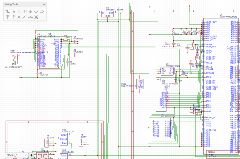

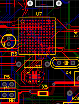

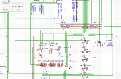

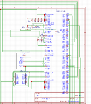

Hi everybody,
I created my custom teensy 3.6 card with a four layer PCB.
I solder the essential for the power supply, the USB and the MKL02 that I have desolders of an original teensy 3.6 await the delivery MKL02 sold directly by PJRC that I buy. But delivery to France will put at least 2 weeks
I have the signal on the USB port 0 but nothing happens when I connect to the pc and I press the button reset or reprogramming.
I suspect the Load Capacitance of this crystals but I do not know how to rectify.
https://lcsc.com/product-detail/SMD-Crystals_Yangxing-Tech-YST310S32-768KHz12-5pF10ppm_C94279.html
https://lcsc.com/product-detail/49S_Hosonic-Elec-E49A16E00000KE10CO_C114981.html
The "MNI" will not be the cause of the problem and the welding is good quality but we never know.
The vbat is powered by 3.3V.
I tried Swapping the D + and D- signals on the USB connector.
I buy the MK66 here and I tested 2.
https://www.mouser.fr/ProductDetail/841-MK66FX1M0VMD18
thank you in advance for your help
