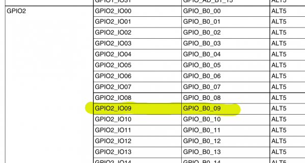

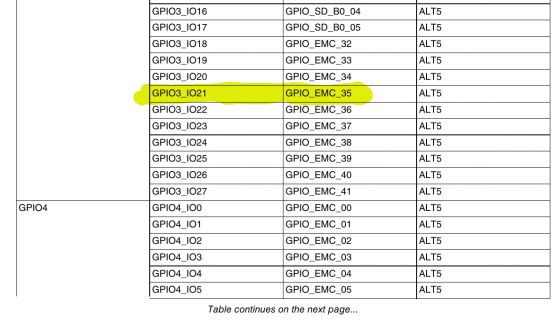

If you want to use the extra pins with digitalWrite(), digitalRead(), pinMode(), you would edit core_pins.h.
The one small gotcha is most of reference manual refers to GPIO1 to GPIO4 ports. There is an alternate set of registers called GPIO6 to GPIO9 which do the same thing, but they're on a faster bus. By default we configure the hardware to use GPIO6 to GPIO9. So if you look up a pin like EMC_35 in the reference manual, on page 302 is says you access it with GPIO3_IO21.
You would actually access this pin with GPIO8 bit 21. So in core_pins.h, you could add defines for bit 21 as expected and the register defines would all begin with "GPIO8" rather than "GPIO3".
Similarly, if you wanted to use analogWrite(), you'd edit pwm.c, for analogRead() edit analog.c, HardwareSerial.h, WireIMXRT.h, SPI.h, etc.
Of course you can always just access any hardware directly using its registers as documented in the reference manual. But often that involves a steep learning curve because many of the peripherals are loaded with a mind boggling number of features. NXP's documentation can sometimes be a little hard to digest.

You could do this many possible ways, but these are probably the most likely, in order of increasing difficulty.
1: Edit the core library files for pinMode(), digitalWrite(), digitalRead()
2: Copy and rename the pinMode(), digitalWrite(), digitalRead(), and edit that copy... eg: myPinMode(), myDigitalWrite(), myDigitalRead().
3: Create your own code using the hardware registers.
The downside to #1 is the possibility your edits could be overwritten and lost if you update or reinstall Teensyduino. Backup copies are essential. Of course, everyone doing creative work should use backup software for all their original irreplaceable data, but in practice many people don't go to the trouble. Just know that it is particularly important if you edit the core library files, because updates or reinstalling may overwrite them.
The first step is to simply find where these files are located on your computer. It varies depending on whether you use Windows, MacOS or Linux, and if you use Arduino 1.8.x or Arduino 2.0.x. The files are also on github, so for the rest of this message I'm going to link to the github files, but know you need to find the copy on your computer and edit those. File search may help. They may be located in folders which are normally hidden. On MacOS with Arduino 1.8.x, they are inside the application bundle, so control-click Arduino and "Show Package Contents" to look inside.
As a very first step, when you first edit the file add an intentional syntax error and click Verify in Arduino to make sure you get the error, as a confirmation you are editing the file Arduino is actually using.
The main pin definition file is core_pins.h.
https://github.com/PaulStoffregen/cores/blob/master/teensy4/core_pins.h
This file is large. It has 3 separate copies of the pin defines, for Teensy 4.0, Teensy 4.1 and MicroMod Teensy. Make sure you are editing in the correct area. Again, adding an intentional syntax error is the quick way to confirm you're editing in the right place. Do this first, because it's possible to waste a lot of time without results if you end up editing lines which aren't actually used.
For each pin you add, you'll need to know the native name and also which GPIO port and bit it is. You already know the native names. Use Table 10-1 in the reference manual. The native names to GPIO starts on page 300. The GPIO ports are 1-4. Teensy uses the fast version, which are 6-9, so you will need to add 5 to the number shown in Table 10-1.
For example, if you edit the defines for Teensy 4.0 which have pins 0 to 39, and you wish to add pin "B0_09" as pin 40, you would first look it up in Table 10-1.
You'll add 5, so for B0_09 the the GPIO is port 7, bit 9.
Then you'll edit the core_pins.h defines. First add the bit 9 part:
#define CORE_PIN37_BIT        12
#define CORE_PIN38_BIT        17
#define CORE_PIN39_BIT        16
[COLOR=#FF0000]#define CORE_PIN40_BIT        9[/COLOR]

If it helps, these are the pins I am looking at (as set up in my custom core_pins.h for digital use):
PORT        |   MODE    |   PAD NAME   | PRT.REG      |  PIN  | PAD
GPIO1_IO00  |    ALT5       AD_B0_00     6.0          |   55  | M14
GPIO1_IO14  |    ALT5       AD_B0_14     6.14         |    56 | H14
GPIO2_IO07  |    ALT5       B0_07        7.7          |    57 | A9
GPIO2_IO08  |    ALT5       B0_08        7.8          |    58 | B9
GPIO4_IO13  |    ALT5       EMC_13       9.12         |    59 | A6
GPIO4_IO14  |    ALT5       EMC_14       9.14         |    60 | B6
GPIO2_IO09  |    ALT5       B0_09        7.9          |    61 | C9
GPIO3_IO24  |    ALT5       EMC_38       9.38         |    62 | D6
GPIO4_IO0   |    ALT5       EMC_00       9.0          |    63 | E3
GPIO3_IO21  |    ALT5       EMC_35       9.35         |    64 | E5
GPIO4_IO10  |    ALT5       EMC_10       9.10         |    65 | G1
GPIO4_IO12  |    ALT5       EMC_12       9.12         |    66 | H1
