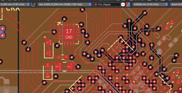

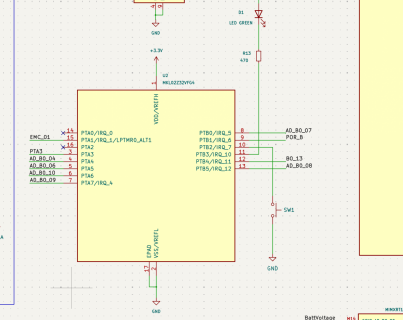

Hi ive made my own custom teensy 4.1 board with the pjrc bootloader from here but im having some issues I cant figure out. Im using the teensy 4.1 schematic but somewhere the bootloader is failing, I was able to write code to it once, just a blinking led sketch, which ran fine, but arduino or teensy software now cannot program over it. I think its the bootloader as the bootloader led also does nothing and it programmed once so usb/mcu is not completely dead. When i try to upload code, teensy software prompts pressing the bootloader button to put the board into programming mode, but once pressed, the processor flashes up in the teensy software but the board is no longer viewable in arduino ide and the blink sketch stops. After a power cycle it resumes the original blink led sketch and shows up in arduino again.
With some probing, the only difference on the bootloader is that pin 4 goes from low before, to high after the button is pressed/ program pulled low.
I realise custom boards are a bit out of scope here but any help/ideas would be amazing thanks

Schematic matches yours as far as I can tell, soldering connections on the bootloader chip itself seem all fine, I soldered the processor myself so its certainly possible theres a short somewhere under there but I can try redoing it soon once my stencil arrives.
