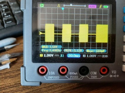

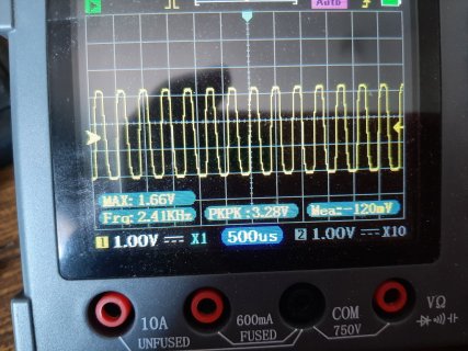

Many Thanks Mark ,
Better than my version for the "note " but on ~2400 Hz ( 4 times the needed )
And the CWspeedWPM is wrong too , at 10 WPM the " dit " must be 120ms and it is ~30 ms
Best 73
Xtian

Hi Defragster ,
Removed the line setFrequency ... had the same : 2400 Hz
If I setFrequency at 150 Hz I get 600 Hz !
Xtian
Some odd 4::1 funny math somewhere? Pushing the Hz up 4X and at the same time the Time Down 4X

setSampleRate_Hz(11025.0) will generate 11025 samples per second but you're playing it at 44100... so of course it's 4x too fast.
