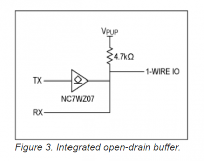

After reading all I can about one wire it seems the MCU is taxed rather hard and I have read that the UART can off load most of that load allowing the MCU to do other things. I have many examples yet no real code to work with. All the examples are software serial and seems to not take advantage of the buffers associated with RX and TX. I have read a few on other forums but the answer was never found or of no interest to people that actually know coding better then us newbies.
What I would like to do is have this code below take advantage of the RX and TX buffers and I know Teensy 4 and 4.1 do not have open drain RX and TX pins. The two included pics are in fact from MAXIM and I am sure they work but I have no clue as to reflect that in the coding.
Any such help would be highly appreciated and this code could help a lot of people out there that want to use UART One Wire for sensors. I would also like to have these put into a struct to send over LoRa to be viewed in the house. Again I am sure a lot of people would benefit from this.
The two examples at the bottom is from Maxim in which i am implementing the first one which both turns push/pull into open drain.
