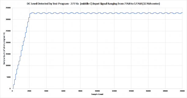

Experiment #1: Port the DC removal code to run on my PC and plot the output of the detected DC:
The result is ugly. Significant noise and sub-harmonic components show up in the plotted data. Also compared same data, same output and synthesis method to my IIR DC removal filter, and the IIR was clean, as expectd. This was simply to confirm my fixed-point synthesis and output was ok. Here attached images:
Here you can really see the aliasing ( 44100/128 - 277 = 68 Hz). Count the cycles and you will see this is about right -- I count about 9 cycles in 6000 samples, 44100/(6k/9) = 66 Hz, pretty close for eye-ball work.

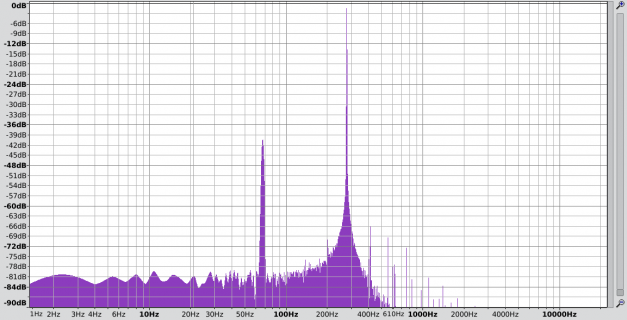

Looped back DAC to ADC directly and analyzed return signal using USB interface and Audacity.
EXISTING DC REMOVAL
The step response and spectral plot make it more evident how the existing algorithm is downsampling followed by a moving average filter. The spectral plots were generated by playing a 277 Hz sine tone into Teensy 3.2 configured as a USB sound card. The Audio was routed out the 12-bit DAC and directly wired to the ADC input.
The result was recorded from the Teensy 3.2 USB sound card input channel and analyzed in Audacity.
FFT of returned spectrum makes the aliased (subharmonic) very obvious. This is coming from the real Teensy and not a simulation of ported code.

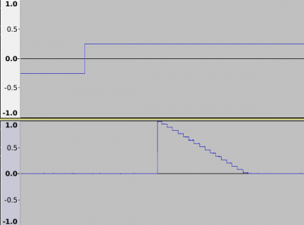

At the end of sine wave transmission this is zoomed to display the tail-end of the transient response of the existing DC Removal code.
This is the step response of the existing DC Removal code. The resampling is realized by integrating the input signal over each flat section of the stair step. The moving-average filter is applied to the sub-sampled signal. The result on the audio is to add in aliasing (and it sounds really bad, particularly when playing chords on a guitar, or music play-back).

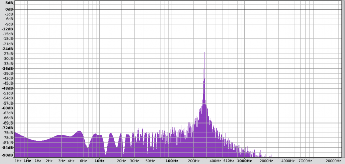

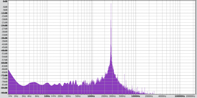

After implementing a high-pass filter at 2 Hz cut-off the following outputs were generated. The -62 dB hump near DC is due to numerical error in the filter implementation. For me it is acceptable but maybe worth a little more time to drop that below the noise floor.
Not sure why the spectrum looks more "dense" above 1 kHz, but the harmonic distortion is lower and the 68 Hz aliased term is gone. The noise floor runs closer to -70 dB (consistent with the 12-bit DAC).

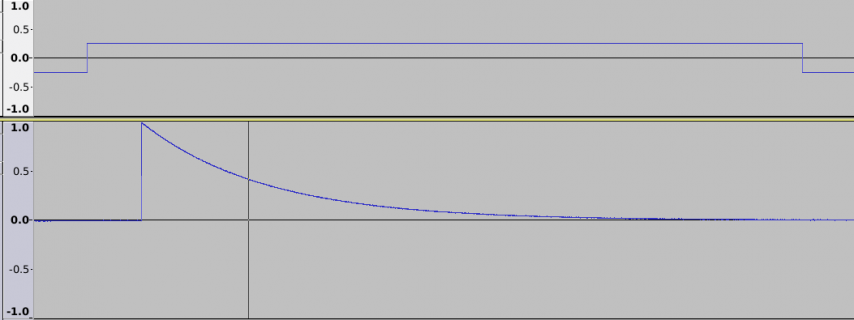

Step response of the proposed filter shows the expected smooth exponential decay.
Updated to higher precision processing to take better advantage of the 64-bit accumulator. Here is what I consider a final product:
