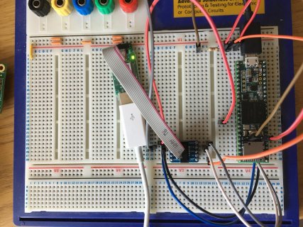

Hi Guys,
I got the debugging going :)
As I said before I couldn't solder a wire to the reset pin so after buying another teensy 3.6 to test on I just cut the PCB trace going to the pin 1 (power) of the KL02Z and added a pull-up resistor (4.7K) between reset and 3.3v, this is currently being done on the breadboard at the top of the image, I'm going to solder it under the header now I know it works.
All working fine with Ozone for programming and debugging, next job is to get it all going in the Sloeber IDE.
Well chuffed.
Andy

After some intermittent problems I also cut the traces to pins 4 and 13 on the MKL02Z, now it is reliable.
I also have a template project for Teensy/Arduino builds in MCUXpresso which offers pretty good support for debugging, if anyone wants it send me a PM.
