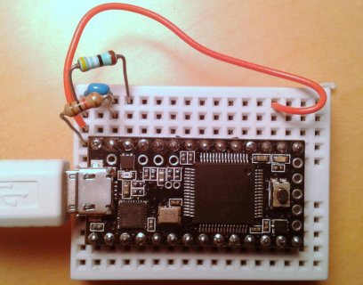

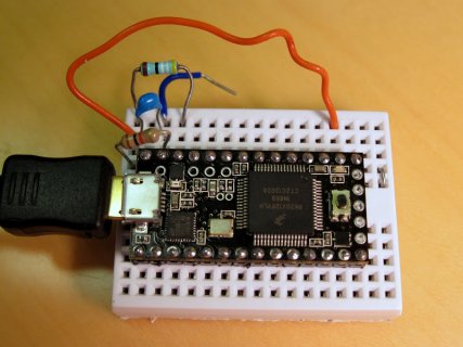

// Analog input test for Teensy 3.0 Oct 4 2012 - Feb 26 2014 J.Beale
// Setup: https://picasaweb.google.com/109928236040342205185/Electronics#5795546092126071650
#define VREF (3.266) // ADC reference voltage (= power supply)
#define VINPUT (2.176) // ADC input voltage from resistive divider to VREF
#define ADCMAX (65535) // maximum possible reading from ADC
#define EXPECTED (ADCMAX*(VINPUT/VREF)) // expected ADC reading
#define SAMPLES (10000) // how many samples to combine for pp, std.dev statistics
const int analogInPin = A0; // Analog input is AIN0 (Teensy3 pin 14, next to LED)
const int LED1 = 13; // output LED connected on Arduino digital pin 13
