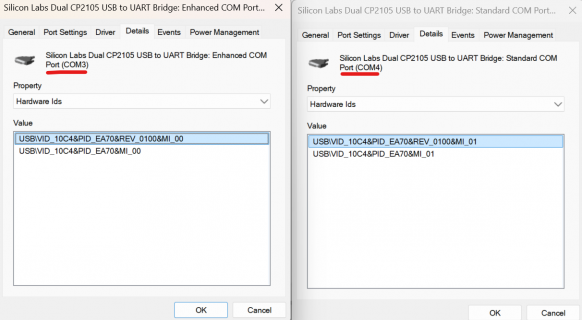

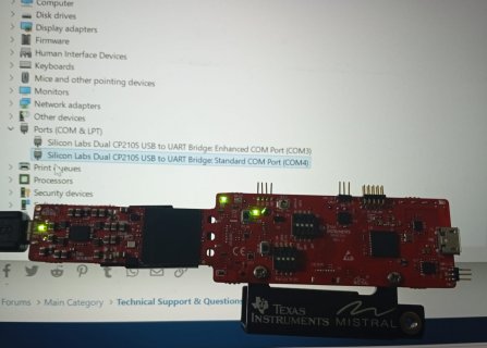

When I just plug the sensor directly with my PC it shows 2 Com port as I discussed earlier, one COM port is used to upload the configuration (the settings used to tune the sensor according to your requirement) and the other COM Port is used to read the data coming from the sensor, previously I was using python to upload the configuration file and reading the data from the sensor and it was working perfectly fine, but the big issue was the involvement of PC because now my goal is to make standalone project of the task I have done. I don't want to go to the raspberry pi boards because firsts python is really slow than C/C++ and also those boards have more awakening time and other stuff because it's basically a whole computer. And in my case the timing is very crucial.

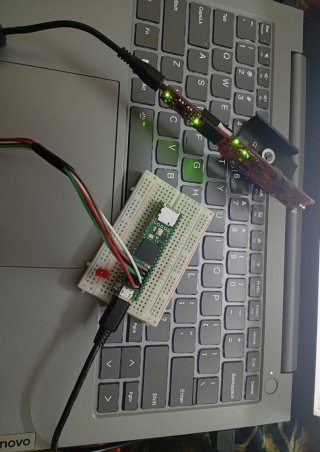

Now among different MCU's I only found teensy that allowed me to upload the code from the PC to the teensy, along with integrating the sensor with it, which was perfect! The logic in python was initializing both the COMPORTS first:

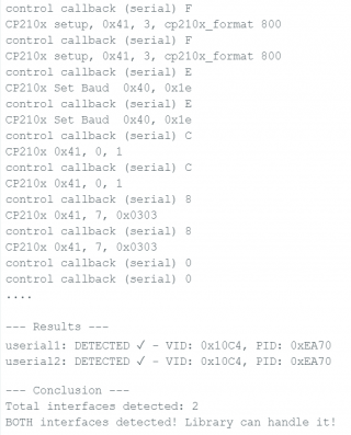

Try editing serial.cpp near this line
add in your boards VID and PID CP… and a 1 instead of 0. You need at least two serial objects defined not sure if you need HID objects
Thanks, KurtE for pointing one of the problems, yes, I need only two serial interfaces to be detected coming from the same device, because the sensor is using CP2105 which is a USB-to-Dual-UART Bridge controller, so I made changes to the file as:
{0x10c4, 0xea60, USBSerialBase::CP210X, 0 },
{0x10c4, 0xea70, USBSerialBase::CP210X, 1 }
I was just curious that can I detect more interfaces as well by copying the above and replacing 1 with 2? like:

My first advice is ignore Claude and try Kurt's suggestion. Kurt wrote much of this code, so he is by far the best person to answer!
You've already changed 0 to 1 for the correct VID, PID line. Do not use 2 or any other number. This code is written for only 0 or 1.
Kurt's other advice was "You need at least two serial objects defined not sure if you need HID objects". Looking at the debug print info, I'm pretty sure you don't need any HID stuff.
You will need to create 2 USBSerial instances in your program. Since this is only 12 Mbit speed device, you don't need the _BigBuffer version.
Your next step for help is to show us your test program with 2 USBSerial instances. Remember, we can't see your screen. For any of us to try helping, we need to see clearly exactly what you are trying.
KurtE can you also tell what is meant by 0 and 1 in these two lines? Does it tell the interface number? I have tried changing these but it when I use the same VID, PID for both the lines it shows no com ports detected, but when I use two different PID then it detects both COMPORTS but those com ports doesn't work as they should be working (i.e. CLI ports works good and configuration files get uploaded but the Data ports shows nothing when I try to read the data from the sensor)
// Silex CP210...
this is the change I made, is it right? I am attaching the images of Hardware ID of my COMPORTS, please can u give it a look and tell me how my #59 lines should be?

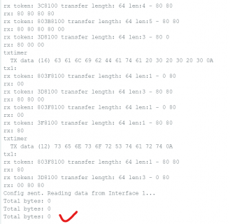

I am using the first code to just simply check if my comports are being detected and then my second code is the full fledge code in which I try to upload the configuration file through the CLI port (interface 0 port) and then read the data from the DATA port (interface 1), but no data is being shown, I think the problem might be that only 1 interface is actually being used for both the task or it might be a problem of port swapping. The second code is:

    while(userial2.available()) userial2.read();
    configSent = true;
    Serial.println("Config sent. Reading data from Interface 1...");
  // Read from Interface 1 (Data port)
  static uint32_t totalBytes = 0;
  static unsigned long lastPrint = 0;
  while(userial2.available()) {
    uint8_t b = userial2.read();
    totalBytes++;
    // Print first 50 bytes to verify we're getting data
    if (totalBytes <= 50) {
      if (b < 16) Serial.print("0");
      Serial.print(b, HEX);
      Serial.print(" ");
      if (totalBytes % 16 == 0) Serial.println();
  if (millis() - lastPrint > 2000) {
    Serial.print("Total bytes: ");
    Serial.println(totalBytes);
    lastPrint = millis();
Now that was all the working I have done. But dealing with these 2 COM ports is still a challenge. Now I am angry on Texas instruments that why didn't they just gave simple UART headers pins for general purpose use on such a board :(, this task might have been a lot simpler when interfacing the sensor with different MCU's.

Sorry I didn't get your point "Have a DUAL USB: "Triple_Serial_Test" on USB host of "SerialTest" and with two lines", and yes I have already included these two lines in my code (you can see my previous comment in which I posted my whole code):
USBSerial_BigBuffer userial1(myusb, 1, 1024); // Assume Interface 0 = CLI
USBSerial_BigBuffer userial2(myusb, 1, 1024); // Assume Interface 1 = Data
The ports are being detected but the data coming from the sensor is not being read by the teensy. I will try to find some other sensor who uses CP2105 chip and see if its communicating with teensy or not and see if this issue is on the sensors side or the teensy. But let's hope I found something in cheap to test.

I need to confirm one thing that are these two lines correct according to my port's hardware_ids information attached in the image? and what does that 0 & 1 represents? interface number?
// Silex CP210...

My problem is that I can't send/receive data to/from the interface 1 and recently I was reading some previous forums, and I found this forum: https://forum.pjrc.com/index.php?th...-issues-with-silabs-cp2105.75211/#post-344623
This person was facing exactly the same issue I am facing and someone replied to him that "Judging from the screenshot of the hardware properties, the enhanced port is interface 0 and the standard port is interface 1. From what I can tell the CP210x driver in the USBHost_t36 library only uses interface 0, it would require a bunch of changes to use interface 1". This means that teensy 4.1 still does not have the capability to use the interface 1 completely.
