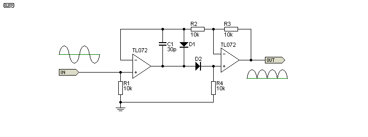

I no longer need to measure the frequency, I just need to be able to kind of reconstruct the sine wave so that I can do some comparisons on the data points.
Now, to increase the range and eliminate the need to offset the inputs to account for a true sine wave, I've decided to use a Full wave precision rectifier using the following circuit (Fig 6):
I can then measure both the positive and negative half cycles for clipping and not have to worry about negative voltage on the Teensy analog input pin.
My next questions are - what is the best way to:
  1. Sample the data at a 250Khz or above sample rate using the ADC library on two different pins
  2. Apply a low pass filter in software to reduce noise (unless a hardwar RC filter is more effective)
  3. Detect the start/end of each half cycle (I don't mind using a min value to detect near zero point, so a low threshold of lets say 10-15mv as my lowest measuring point)
