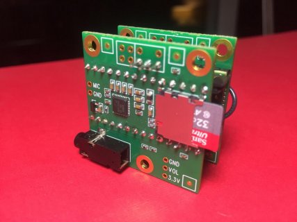

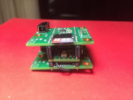

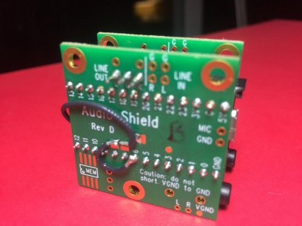

I’ve wired up a Teensy 4.0 with two Audio boards for the quad output setup with a 32GB SanDisk Ultra SD card and it’s working splendidly. This forum (especially https://forum.pjrc.com/threads/61123-Teensy-4-1-and-4-channel-audio-(AudioInputI2SQuad) ) was a goldmine of useful info. But now I’ve run into a problem that I’m having trouble diagnosing.

My hunch is that the SD read speed might be the bottleneck. I’m using the SD reader on one of the audio boards. But I might be missing something obvious. I’m new to the Teensy and could do with some pointers.
