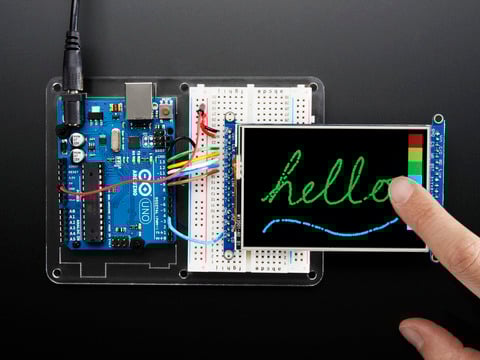

ILI9488/86 - Have 3.5" displays
HX8357: 3.5" display
RA8875 - They have several different sizes like 4.3"
https://www.adafruit.com/search?q=RA8875 They sell a controller and displays that can plug into it.
RA8876 - Likewise a few different sizes. I have 7"
