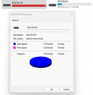

Thanks MichaelMeissner. I copied and pasted your code and it worked straight away!
One small thing - in Windows Explorer, the BUILTIN-SD capacity bar appears full red for me, despite the SD card being empty. I'm running a Teensy 4.1. Does this happen for you as well? Not a big deal honestly, just a little OCD on my part.
Using Teensyduino 1.58.1, using SdFat Version 2 that came with 1.58.1, no other SdFat libraries. Using 32 GB microSDHC Fat32 formatted. MTP_t4 as linked above.
I fixed my issue. Problem was that sdx[ii].totalSize() and sdx[ii].usedSize() were returning 0.
In SD.h (teensyduino library) there is:
uint64_t usedSize() {
		if (!cardPreviouslyPresent) return (uint64_t)0;
		return (uint64_t)(sdfs.clusterCount() - sdfs.freeClusterCount())
		  * (uint64_t)sdfs.bytesPerCluster();
	uint64_t totalSize() {
		return (uint64_t)sdfs.clusterCount() * (uint64_t)sdfs.bytesPerCluster();
I commented out the
statements and it now gets the total size and used size of the SD card.
@Berollos :
I made the same experience.
The boolean cardPreviouslyPresent is defined in SD.h and will be changed in SD.cpp but in the header file it behaves like a constant.
  // from MTP_t4\examples\mtp-test   approx. line 112 in original
        if(cs[ii] == BUILTIN_SDCARD)
          //if(!sdx[ii].sdfs.begin(SdioConfig(FIFO_SDIO)))  ****  exchanged this  ****
          if(!sdx[ii].begin(cs[ii]))
          { Serial.printf("SDIO Storage %d %d %s failed or missing",ii,cs[ii],sd_str[ii]);  Serial.println();
            storage.addFilesystem(sdx[ii], sd_str[ii]);
            uint64_t totalSize = sdx[ii].totalSize();
            uint64_t usedSize  = sdx[ii].usedSize();
            Serial.printf("SDIO Storage %d %d %s ",ii,cs[ii],sd_str[ii]);
            Serial.print(totalSize); Serial.print(" "); Serial.println(usedSize);
When I exchange the method for begin to the SDClass method it worked like expected.
