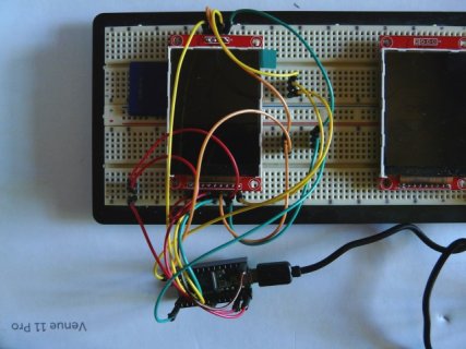

If that still doesn't make listfiles work, then something probably isn't connected properly. Maybe post some photos of your connections? Perhaps we'll be able to see what's hooked up wrong with some good pictures....
Paul suggested that I add a pinMode statement to check if there was any conflict with the CS line from the screen. I added one. It didn't help. He also suggested that I send a picture of my wiring. I attach one which I hope is useful. sypniewski051315.jpg

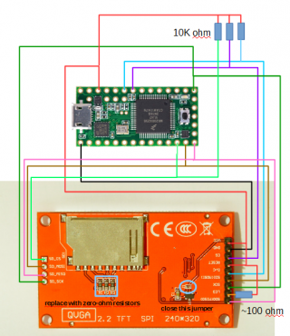

I've modified my ili9341 display a little bit.
  • The resistors R1, R2 and R3 are replaced with 0R resistors,
  • ~10k pull-up resistors for SD_CS, TFT_CS and TFT_D/C
  • the solder jumper J1 is closed.
The display is now 3.3V only - max voltage for VCC is 3.3V!
The spitftbitmap example runs without problems (Arduino 1.6.4 & Teensyduino 1.23beta2). Same with SD/CardInfo and ILI9341_t3/graphicstest.

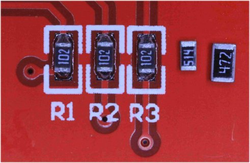

Thanks for this HWGuy. I'll try this tomorrow. There were no resistors mentioned on the web page. What are R1, R2, and R3 (what is 0R resistors?) and where do they go? It looks like one goes to the LED, one to Vcc, and one to 3.3v; is this correct? I can't make out where the pullups go (in the picture). J1, I take it, is on the Teensy. Your help is appreciated, oh Swami.
R1, R2 and R3 are smd resistors on the rear side of the display. 0R is a zero-ohm resistor. J1 is this tiny solder jumper near the voltage regulator.

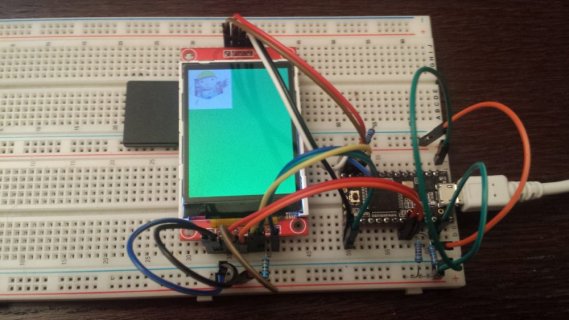

On my display, I've soldered a short wire instead of the zero-ohm resistors
By R1 I've ripped off one pad and had to connect the sd card socket directly to the other pad on the pcb.

In the spitftbitmap example we start communicating with the tft display before we did set up the sd card properly. The CS (chip select) line of the sd card is floating until this code: if (!SD.begin(SD_CS)). With our breadboard and the long jumper wires which act as little antennas - the odds are good that we catch some interferences, the voltage of the sdcard cs drops (spi devices are active when the cs line is low) and the sd card starts responding to commands from the Teensy - to commands which were meant for the display. To prevent this, we can use the pullup resistors or configure the pin with pinMode/digitalWrite as output/high at the beginning of setup(). To get the spitftbitmap example running without code changes, I've choosed the pullups. But as mentioned in another post, you can try it without the pullup resistors.
btw. the 3 resistors on the display are 0805 package. 0603 size is ok, but smaller and a bit harder to solder.

on the picture you can see all hardware modifications I did.
1: close the solder jumper J1
2: replace each of the 3 resistors (R1, R2 and R3) with a zero-ohm resistor or a little wire. (the ripped off pad by R1 was an accident and was repaired with the longer wire to the sd card socket)

Mine are 0603.
On my board, the resistors are 0603. I have attached a photo with a 0603 and a 0805 resistor to the right of R3 for size comparison.

oh ok. on my display they are 0805 :rolleyes:. But I can see that we do not have exactly the same display board. The routing of the traces is a little bit different too.
