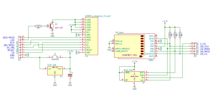

Since these pins will be actively driven, there is no need for such a small pull up resistor.. All it does is increase power consumption... I'm just getting started with the teensy (just bought it) so I can't test anything yet, but when I do low power designs I never use anything smaller than 100k unless the interface spec dictates it. It may seem insignificant but all these pull ups add up!
You are correct, there is no reason to use this low of a resistance for pullups with CMOS circuits. A 100K pullup is still a bit wasteful for battery powered designs, 1 M will also work. 100K with a 5v supply if driven low by the microcontroller uses 250 microwatts of power. 1M uses 25 microwatts of power. If one is trying to conserve battery power even more, change the code to use the internal pullup resistor in the microcontroller for the short period when it is needed during initialization, then reconfigure the GPIO for output when actually using the GPIO pin. This gets rid of the static wasted power of the pullup for the majority of the use of the device. (Typical designs only initialize once per power cycle) Designs that go to sleep, then wake up and re-initialize hardware can still use this technique, but the battery life is likely to be more dependent on the duty cycle of sleep time vs active time then.

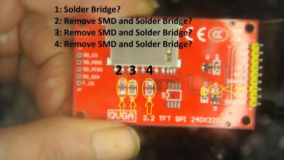

I have a board I just got which is different than the ones shown here.
Am I correct that doing the following will allow me to connect this directly to a teensy3.1 without needing a line converter AND be able to use the other pins to use the SDCard reader as well?
Reason I ask is because it looks like there is already 2 regulators onboard with 1 being for the SDCard and the the other for the LCD.

And I was able to get the graphics tests working using the ILI9341_t3 libraries with 0 modifications to the board. Well as far as the LCD goes. I'm still not sure if I should be able to use the SDCard over the same pins as the LCD or if I have to use the pins on the other side of the card.

These boards tend to keep the SPI lines of the SD card and display separate, but have a look at the traces and see if they connect, or better yet, use a multimeter to test for the connection.
If not, you can always join the SPI busses together on your breadboard.

With other similar versions, including the one we sell (which we get in bulk from similar Chinese vendors), the SD signals are totally separate from the LCD signals. You'll almost certainly have to connect to both sides.
Oh, that's interesting. On older displays, the 3 resistors seemed to be in series with the signals. Are they really just pullups now?
If so, seems like it might work as-is, without having to desolder and replace the resistors.
yes only pull-ups. The display/sd card works without modifications. Vcc connected to 3.3V from the Teensy 3.1. And [LED] without resistor to 3.3V or a pwm pin. The backlight brightness is controllable with pwm.

Thanks for the reply. You can share pins? I already have the LCD on pins 11/12/13. If this is the case can't I just run a bridge between the SD_ and LCD_ MISO/MOSI/SCK?
yes you have to share the pins. The Teensy 3.1 has only one SPI module. You can connect more than one device to the SPI bus (MOSI, MISO, SCK are part of the SPI bus). The active device on the SPI bus is selected trough the *_CS pin (chip select or slave select). When SD_CS is low, the Teensy 3.1 communicates to the sd card, with CS (from the display) low the Teensy communicates with the display.
