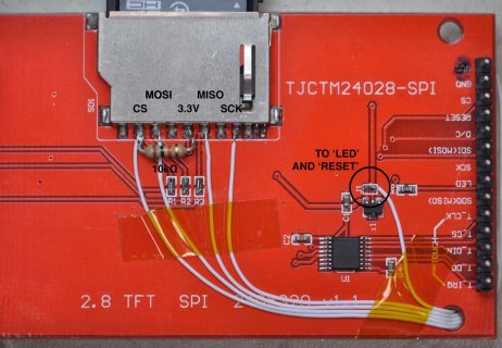

Are you sure you are using two separate Chip Selects ? One for the SD card and a second one for the TFT Display. Both CS pins need separate pullups.
That's not a problem with the display, it is a software-problem. Perhaps a problem with the SPI-Driver or whatever is used to access SPI. Do you have pullups on all chipselects ?

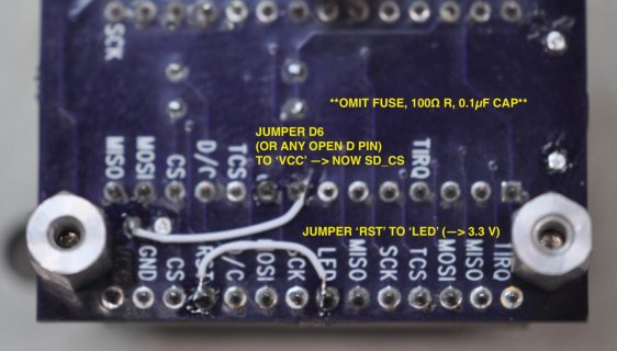

SD_CS: any free digital pin
SD_MOSI: 11
SD_MISO 12
SD_SCK: 13
F_CS: this is the chip select for the not populated flash memory chip

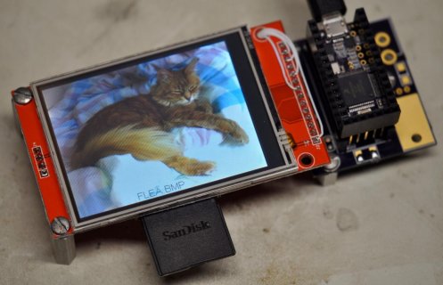

I've modified my ili9341 display a little bit.
The display is now 3.3V only - max voltage for VCC is 3.3V!
- The resistors R1, R2 and R3 are replaced with 0R resistors,
- ~10k pull-up resistors for SD_CS, TFT_CS and TFT_D/C
- the solder jumper J1 is closed.
I take it that since I have a Teensy 4.1 with a built in SD (Thanx so much Paul for helping me get the SD up and running) I should have no concerns about SD cards and the display working, as long as I connect the display to the pins shown in the device description and use the suggested libraries. Is this right??
