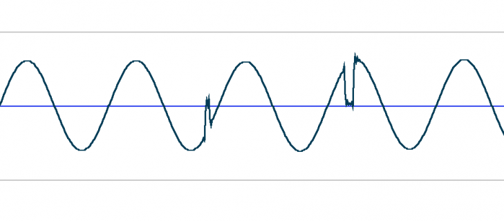

I have a Teensy 3.1 and Audio Shield Rev B which I have configured to be a USB audio device. My problem is that the audio from the computer becomes distorted after 2 minutes.
Here's some recordings of the issue
Music: https://drive.google.com/file/d/0B89PTFSyNDGZTnd4cHpmUWVvV0U/view?usp=sharing
Sine wave: https://drive.google.com/file/d/0B89PTFSyNDGZT0JGdjBtSnlFOUU/view?usp=sharing
You can see the issue visually here from the sine wave distortion. It looks like the teensy is getting underruns and outputting zeros instead of the audio data:
I thought originally that this was a problem with the audio shield, however, I have subsequently connected a piezo buzzer to the DAC pin on the Teensy and I can hear the same distortion. I have also eliminated a fault with my Teensy by testing using a second identical Teensy and audio shield. It exhibits the same issue.
AudioInputUSB usb1; //xy=200,69
AudioOutputI2S i2s1; //xy=365,94
AudioConnection patchCord1(usb1, 0, i2s1, 0);
AudioConnection patchCord2(usb1, 1, i2s1, 1);
AudioControlSGTL5000 sgtl5000_1; //xy=302,184
AudioMemory(12);
sgtl5000_1.enable();
sgtl5000_1.volume(0.6);
