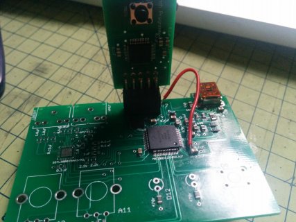

Hi all,
I received my second round of PCBs based on the teensy and audio shield schematics put together and am disappointed to say that once again I cannot get them to work. I am burning through the Mini54 chips at the moment!
My last design appeared to work - the verbose output form the teensy loader said everything it was supposed to, but the MK20 just did nothing. I went back and greatly simplified the circuit and improved the decoupling. This time, I get nothing from either chip. While I'm not an EE, I think I understand the design principals well and am really pulling my hair out trying to sus out why they don't work.

I've had a good probe - all power and ground pins are ok.

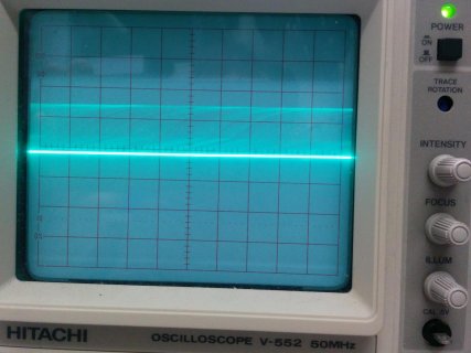

Neither of the chips is showing any sign of communication and when probing the Reset line from pin 8 of the Mini54 I get some weird noise on the scope:
There is no change when I connect pin 20 (P5.2/Program push button) to ground. Any ideas what that might be?
I'm pretty confident the crystal isn't interfering with this part of the circuit since power trace running under neath it looks OK on the scope:
Presumably then there is an issue with the basic functionality of the Mini54, which would only be affected by power, ground or P5.2?
Many thanks!

I can't say why your hardware isn't working, but from this photo, it seems pretty clear you need to adjust your oscilloscope's trigger threshold & holdoff settings.
Yes you're quite right sorry... It's actually a pulse from GND to +3v3 at an interval of ~56 uSecs, which is about 17.8KHz, ~1000 times slower than my crystal should be... Could this still be caused by the crystal do you think?
@johnnyfp - The mini54 does actually work when not attached to the rest of the board.. So it must be an issue with the main board.
My next step is going to be to cut the VCC trace running underneath the crystal and wire it straight to the mini54 board.
Thanks for your patience everyone...
aaaand IT WORKS! Turns out the problems were running VCC under the crystal along with the capacitance load settings for the crystal.
I rewired it like this:
And changed the settings as Paul described, and I've got a blinking LED. Think I'll leave it a few days to enjoy the elation before testing the audio part of the circuit...
