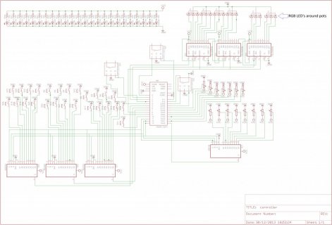

EDIT: I've sketched up a quick schematic to show how everything will connect to Teensy 3.1 (all the pots, encoders and buttons)
Those LED's in the top left are simply for illumination in my design (they're not controlled by anything).
Also 4051's are used to multiplex buttons and pots

On the schematic, here's a few quick comments....
I don't see any current limiting resistors on the RGB LEDs. Unless the LEDs have them built in, you probably need to add resistors.
You probably want to use 74HCT595 shift registers. The "HCT" ones are designed to run on 5V power, but they properly receive 3V signals.
The 4051 chips should be run from 3.3V power. Use 74HC4051 chips. The old CD4051 types are rated to work up to 15 volts. When used at 3.3V, they work, but not nearly as well as the "HC" types that are optimized to perform well at lower voltages.
In the upper right corner, you've got 24 LEDs running from 5 volts, each with 100 ohm resistors. If those are blue LEDs (approx 3.2V), each will have approx 18 mA. If they're red (approx 1.8V), each will have about 32 mA. Multiplied by 24, that adds up to quite a lot of current, and that's on top of the RGB LEDs. USB has a 500 mA maximum when connected to a PC or powered hub, and 100 mA on unpowered hubs. You might need to scale the current down (increase the resistor values) if running only from USB power.
Ah yes, I forgot to add those resistors on the RGB leds :p
Thanks for the info about the chips though, I was slightly confused at all the variations of 595's and 4051's. Since you said power them with 3.3 volts, that means adding a resistor on pin 16 right? (The vcc pin for 4051's)
In that array of leds, I'm using these quite bright red leds (I chose bright ones so they can shine through the parts of the enclosure) the forward voltage for them is 2.4V, the average forward current is rated at 30ma, the maximum I believe is 50ma (I'll find the datasheet soon). If I lower that to 20ma per led, that means 150ohm resistors. This should be high enough so a USB port can supply enough current to all the LED's right?
