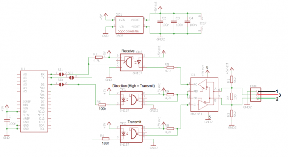

I am using the attached circuit off my Teensy 4.1. There seems to be several variations of this circuit floating around.
My question...
Obviosuly the Teensy is 3.3v. This circuit actually does seem to work with DMX lights, even though it falls below the 3.5v minimum for the DC/DC isolator.
But, in the long term, that should not really remain.
If I run this circuit on the recommended 5v, my concern is the RX/TX connections.
I don't really want to have to make a new board (I have made this pcb already for another 5v project).
I am sending a serial low signal I assume to the TX of the transmit isolator, and a simple low for the direction isolator, so I think they are OK.
But the returning signal from the receive isolator is potentially 5v?
Also, are R4 and R6 correct at 100R? Seems low to me.

The voltage across the LED is 1.3V or so, yes. The point is the current through it.
Those 100R resistors on the opto couplers for TX and D2 will try to pull lots of current from the T4 pin, far more than they are designed for. This circuit seems to be for an Arduino AVR which can push out 25mA per pin(*). I think for the T4 you should bolster the outputs with a transistor or FET so they can drive the opto couplers at 25mA.
(*) AVR output pins have about 40 ohms of internal resistance, so total resistance = 100R + 47R = 147R. 3.7V/147R = 25mA
However note the 6N137 only needs 5 to 15mA of drive anyway so those 100R resistors really could be 390R or so, which would be much friendlier to a T4 drawing about 5mA which might just work without extra hardware.

So.. a 390R resistor on the input to the 6n137 seems to work. Turned out I had a dud opto-isolator (maybe I fried it).
I looked at the data sheet for the 6n137 and just don't see the forward voltage for the internal Led. This 390r probably pulls a tad over 5mA from the Teensy 4.1 pin? Is that gonna be OK long term. Really wish Teensy pins had a little more than 4mA a pin.
Bizarrely, I connected the same PCB to an ESP32 devkit IC and it doesn't work. I suspect the resistor is now too high, as I am sure this PCB worked with 100r resistors in it on the ESP32 last time.
I don't see why the output level of the ESP32 is different to the Teensy 4.1.
