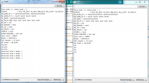

I'm using this library with Teensy 3.0 and a NRF24L01+: http://playground.arduino.cc/InterfacingWithHardware/Nrf24L01
I checked the code, and it doesn't seem system dependent because it uses SPI interface. The code that I'm using is the ping_server and ping_client example. The only difference is I'm setting up CSN and CE like this:
Mirf.cePin = 9;
Mirf.csnPin = 10;
For testing purpose I used 2 arduino Uno with the same code to make sure everything was wired correctly. Now, I'm moving my ping_server to the Teensy, it compiles and uploads ok. But I can't get the packets on it.
Maybe something that I'm missing?
I used this pins:
SS (CSN) = 10
MOSI = 11
MISO = 12
SCK = 13
CE = 9
IRQ = DISCONNECTED
And connecting as the following image: http://arduino-info.wikispaces.com/file/view/24L01Pinout-800.jpg/243330999/24L01Pinout-800.jpg
On uno it works, on teensy it doesn't.
Any ideas?
Thanks
