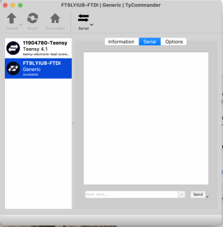

Does TyCommander handle FTDI? Or am I doing something wrong?
clinker8
I'm adding a FTDI cable for some data logging for my ELS (to avoid badly behaved USB transactions) and can't seem to get anything. When I use TyCommander it sees the FTDI device.
I'm on Mac running the latest and greatest OS. But in the serial data window, I get no data. Also the bottom, where one would be able to send data appears to be disabled. I can't write to the area. But using the USBSerial connection, sending data is fine. Here's the snippet of the FTDI initialization

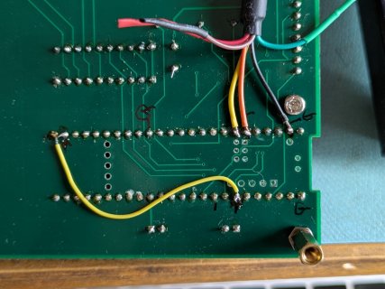

Backside connections.

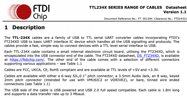

Documentation for the real FTDI cable.
Did I get the wiring wrong? The set up? Or just a bad solder joint? Yeah, it's a little ugly there, I'll inspect it with a magnifier.
Under 'Options' tab check that the Rate matches the .begin( ## )?
Can the FTDI unit do 3 MBaud? :: FTDISerial.begin(3,000,000);
With it is showing in the UI the USB<>FTDI unit is working and recognized
It's currently greyed out at 115200 in TyCommander.
According the the FTDI datasheet it supports 3MBaud.
However, the native Apple MacOS FTDI driver might not support 3Mbaud. The FTDI documentation is quite old, the latest release of Mac SW mentioned is 10.9, I'm running 15.5.

I am using an authentic 3.3V FTDI cable, sourced via Digikey. I just found out by contacting FTDI tech support that I do not need to install any drivers, as FTDI support is built in to MacOS now. They also suggested a loopback connection and to use minicom to set up the interface to 3Mbaud, no flow control. So, I'm going to try that now.
My FTDI cable is working. Did a 3M baud loop back, at least according to minicom. Turned echo on and off and got double characters, or not. Now to check if Teensy is transmitting at all, I will need to set up a scope for that.
Teensy is transmitting, both disconnected, and with the FTDI yellow wire (RX in) attached to the Teensy TX5 pin. I can see the 3Mbaud burst.
TyCommander is not picking it up at all. TyCommander has not picked up the correct data rate, it's still set at 115200 and greyed out, so I cannot set it. If TyCommander is using screen as it's hook, it won't be able to use the max baud rate of the FTDI. Minicom can use up to 3M.
TyCommander sees the FTDI device, but cannot display the data. It displays no data.
However, if I bring up a minicom terminal, the output is present. I'd say this is a weird TyCommander bug.
Pity that TyCommander can't display the data, as minicom is a dinosaur program that is really DOS era weird to use.

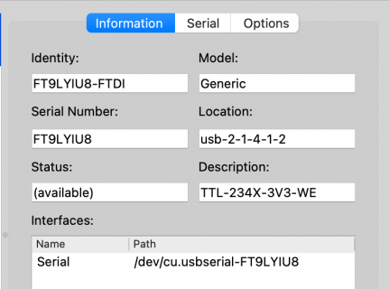

Interesting. Mine is a genuine FTDI cable, sourced from Digikey, 6/9/2025, so I'd expect it to be authentic.
PN: TTL-234X-3V3-WE. Mfr: FTDI, Future Technology Devices International Lt. Digikey PN: 768-1322-ND.
TyCommander just sits there, I get zippo on the display. I don't get the two way symbol, there's a bar through mine. Like it's broken...

If I right click on the FTDI on the left and attempt to enable serial, I get the following error in the TyCommander log
tcsetattr() failed on '/dev/cu.usbserial-FT9LYIU8': Invalid argument
Right clicking on the Teensy icon shows the serial interface is enabled. The FTDI interface is NOT enabled in TyCommander, TyC can't communicate with it, or so it seems.

@defragster Ahem, loop back worked. I needed to enable the interface! Now to hook it up again and see if things still work. Funny, I didn't need to explicitly enable the Teensy... Time to turn on the iron again...
Got wires attached. Now there's at least some garbage on the screen. Now the device came up enabled.
TyComm doesn't seem to auto adjust the baud rate for FTDI. So I set the baud rate. Sadly, the maximum baudrate in TyComm is 230,400. But FTDI can do 3,000,000. So TyComm is limiting reception to less than 7.7% of the adapter capability for FTDI. My opinion that's lame, especially since the true USB side can much faster. But, it's quite possible that once again, I have missed some magic incantation!
Got FDTI to work for 230400 baud. This is not good enough, need practically the full FTDI bandwidth, nearly 3Mbaud. Actually, even 3M may not be enough, but I'm going to exhaust that possibility before I *have to* use ethernet. I'm trying to avoid ethernet, as it's a whole new can of worms, mostly because I haven't done anything like it on a Teensy. And I'm kind of scared that the platform is going to run out of gas for the machine control application AND running ethernet.
:love:Indeed, have to pick one of the few supported entries. Not sure if there was a code reason for that limit? When the edit was asked for that was where they topped out IIRC.

TyCommander will not connect automatically, nor auto negotiate up to the FTDI speed. It doesn't, I tried. I had expected it to work identically to USBSerial, but it doesn't. At least for my authentic FTDI cable.
FTDI is not my first choice, it was chosen because the complexity of management was low. I had considered ethernet, but my experience with it on Teensy is minimal. I did get some examples to work, but I have not tried anything at the scale that would be required. Just didn't want to get in over my head on yet something else. I'm already in trouble with understanding why I have this bug, I really need less complexity, not more. Continually increasing the scope of a project is a sure way to kill it. I want this to work, so I have to keep the scope achievable.

If I am looking right, the FTDI document Appendix A for your cable I see:
You might try to find something that uses a Higher speed USB, like FT232H like:
Example: https://www.adafruit.com/product/2264
Not sure how well it works as I don't have any, but...
