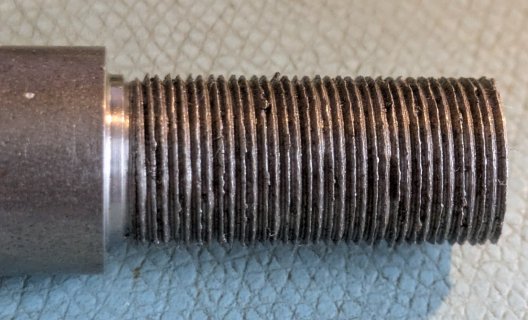

Maybe it's time to take a step back and review again. Do I have this right?
  • Your ELS works well most of the time, but occasionally glitches, and you're trying to figure out why.

It's kind of complicated, but simple at the same time. When you cut a threads on a lathe, they are usually cut in multiple passes, since most (99% of them!) lathes are not massive and rigid enough to do it in a single pass. This creates a requirement to have successive helices to overlay the same path as the original cut, but be a little deeper every time. So sync is in effect to the original cut. It's actually a rotational error.
At t=t0, the cutter has to be at z=z0 (the start of the work piece) AND the spindle angle has to be at theta = theta0, and the position of the carriage has to be at a fixed known ratio to the spindle angle. As the spindle changes angle, the carriage and cutting tool progresses linearly. At t=t1, the next pass, z, and theta have to be at z0 and theta0 along with the carriage position locked to the spindle angle at the same ratio as before. I have a DRO (a linear encoder with 1um resolution) on z, and a rotary encoder (4096 counts/rev) on the spindle, so I know very accurately where they are at any moment in time.
At 400 RPM, my test speed, I cut a single light thread in a piece of material. It threads at the correct pitch, and stops automatically at the stop point. I then retract the cutter, so it won't cut, then go back to the initial start point again. Then tell the machine to go. I can observe the cutter doesn't follow the same path. It cuts a helix of the proper pitch, but it is phase shifted, so the cut would no longer be tracing out the previous path. If I repeat this, I find, for the most part, the helix is randomly phase shifted from the starting cut. Maybe 5% of the time, it falls on the original and correct path.
At 400 RPM, the spindle revolves once in 150 ms. So we can express phase error to time error. 75 ms would correspond to 180 degrees of phase error. If there's phase error, the screw is effectively ruined and headed for the scrap bin. If the error occurs in a deep cut, ie a very coarse thread near the bottom, then the lathe can stall, or break, or break the tooling, as the forces can become very large, with an effectively stalled cutter relative to the thread which is still turning. At least on my lathe, I can't cut 1/4" deep in steel in a single pass.
For what it is worth, the phase error (or timing error, take your pick) doesn't seem to be strongly related to RPM, which I find surprising. I tried 200 and 100 RPM and see similar random like phase errors.
Anyways, the problem has been confounding me for 4 months now... It bugs me, since well, it should work. I have all the information to recreate the tooling path vs time.
If this is unclear, please ask more questions.

Some good ideas. For these tests I have to use a coarse thread, simply because it's easy to see if there's a phase error, the cutter tip is obviously not in the groove. With a fine thread, it's impossible to see. But coarse threads advance VERY quickly, so it's hard to follow by eye. So much so, that I need to have the tip of the cutter 0.005" from the rod, and have to stare watching this very quick event. A 4 TPI thread, advances 1/4" in 150 ms, at 400 RPM. Believe me, I was scared doing this initial testing. But my stopping control loop seems to work ok. (Based on Z.)
Since the threadline (the line the cutter takes on the rod) isn't repeating currently, if I leave the cutter in place, it rapidly makes a mess of the rod, and I no longer can tell where the first line was after a couple passes. It's not like it's a red line, it looks like the other ones. So I have to turn the rod, so I get a fresh surface to observe.
Here's a picture what happened when the phase was off by ~180 degrees. Basically the TPI doubled, and created burs, and ruined the thread.
I started out with full diameter, and well, you can see that I wasn't so successful that day.
