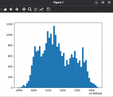

I've connected a PPS (pulse per second, by using a GPS) source to a Teensy 4.1.
Then I measure the number of cycles (via ARM_DWT_CYCCNT) between each interrupt. I do that both in the interrupt handler and in "loop()".
The one in the loop-function produces an histogram that I expected:
one bump. Note that the x-axis is in nanoseconds with an offset (see the +9.9999e8). Y-axis is how often a measurement was seen. 50 bins.
If I do the same with the data from the interrupt-routine, I get:
My question now is, why are there 2 bumps?
The interrupt handler is:
volatile uint32_t d = 0; volatile uint64_t ts = 0; uint32_t delta_nanos_32(uint32_t *const last) { asm("dsb"); uint32_t c = ARM_DWT_CYCCNT; uint32_t m = c; c -= *last; *last = m; return c * 1000000000ULL / F_CPU; } void int_func() { static uint32_t last = 0; d = delta_nanos_32(&last); ts = micros_64(); }
The loop() function also uses delta_nanos_32 by the way.
Oh hang on, maybe it (the two bumps) is caused by the Ethernet interrupt. My goal was producing a simple time server so I enabled Ethernet. I'm now testing (will take a few hours) what the graph looks like with Ethernet disabled (I expected that the GPIO interrupt would have a higher prio than the Ethernet handling).
The trouble with either of these methods is that many Teensy libraries disable interrupts completely for an unknown length of time. Usually pretty short, but it wrecks all attempts to measure a signal’s period by hooking it to a GPIO interrupt, let alone in loop().
If your GPIO interrupt is lower priority, or blocked by disabled interrupts, then you’ll occasionally get one “long” period followed immediately by a “short” one, leading to a double peak … actually, thinking about it, it ought to be a triple peak … short, correct and long … hmmm. Everything will then be smeared further by different durations of blocking time.
You’d be much better off using one of the purpose-built libraries, like FreqMeasure, which use Teensy hardware capabilities to capture a precise cycle count regardless of interrupt priorities or masking. The downside is you often need to use specific pins.

Without Ethernet, without asm("dsb") it looks like:
Slightly different.

Still pretty dreadful compared to the likely accuracy of your 1PPS signal (though you haven’t provided a link to a datasheet, so I’m slightly guessing here…). The spread is over 300 CPU cycles, or 0.5μs, whereas I believe a decent 1PPS signal can be well under 0.1μs.
Then again, that might be good enough for your use case.
