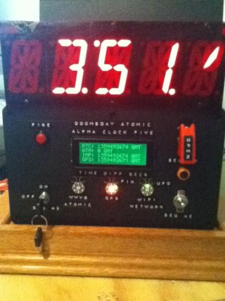

I wanted a clock that would display precision time and date in "all" worst case scenarios.
If this clock does not show the precise time then its time to gather up food, water, ammunition,
and the family and head for the underground bunker!
This could happen - imagine this scenario ....
The World Wide Web (Internet) goes down.
All the US Military global positioning satellites (GPS) stops working.
The 60Khz WWVB pulse radio towers (Atomic clock) at Fort Collins, Colorado cease operation.
The electrical power grid cease to function.
All cellphone towers are in-operational.
All POS telephone land lines stop functioning.
All TV and cable systems are in-operational.
It's the end of civilization ... Doomsday! Do you have the precision time and date?
I may be dead and long gone but my Doomsday Atomic Alpha Clock Five would be still functional, working and indicating the precision time!
In this project, we used a GPS, a WiFi Electric IMP (network time), a custom built WWVB Atomic radio receiver, two precision TXCO real time clocks (+- 2 PPM SPI DS3234 and I2C DS3232) and two micro controllers - (Teensy 3 ARM stamp & Arduino 328P clone). We then use the three precision clock sources (UNIX seconds) to drive or sync to the Evil Mad Scientist huge, very bright, "Alpha Clock Five" 2.5" clock display.

DoomsDay Atomic precision clock driver features
using the Teensy 3 ARM stamp
•Two precision temperature controlled (TXCO) real time clocks (+-2 PPM SPI RTC DS3234 & I2C RTC DS3232). These TXCO RTC clocks can be removed from ambient temperature surroundings
and would still have minimal drift. +- 2 PPM = 0.17 seconds/day = 1.05 minutes/year
Ref. http://www.maximintegrated.com/design/tools/calculators/product-design/rtc.cfm
•High-quality "Ultimate" GPS module that can track up to 22 satellites on 66 channels and has an excellent high-sensitivity receiver (-165 dB tracking!) - Used for a precision time / date clock source.
It can do up to 10 location updates a second for high speed, high sensitivity logging or tracking.
On the GPS module there is a link status LED that cycles every 15 seconds to indicate a satellite fix is found. An optional "active" external antenna was used to help boost the GPS signal reception inside the housing structure.
•Wifi "Electric IMP" SD card for network time. A yellow status LED indicates wifi link connection and operation on this custom built breakout board. This yellow status LED toggles on/off every second for network time updates.
•A 32 bit ARM processor stamp (Teensy 3) used for the main "Atomic" clock driver operation. This resource heavy ARM micro controller has plenty of GPIO, hardware serial ports, flash, RAM, CPU MHz and peripherals to process all the time clock sources in a timely fashion.
•A 4 pin 2 mm. JST, modular, solid, organized, connection system for the Teensy 3 ARM stamp module. This Mini T3 Baseboard, provides power, ground and GPIO signal separation needed
in connecting all the numerous wired clock sources up easily to the Teensy 3.
•An "Atomic" WWVB 60 KHz time radio "clone" receiver with an Arduino compatible pre-processor with status color bargraph. This cool LED bargraph indicates Atomic radio reception, decode status and processing.
The "Atomic Clock" WWVB 60KHz RF source is from Fort Collins, Colorado USA. This Atomic clock source is also known as a cesium oscillator. Cesium beam atomic clocks are stable to 1 x 10-13 (8.64ns/day 8 billionths of a second!) or 259ns (259e-9 seconds) a month (ppm is 0.0000001ppm !). Note: For practical purposes, our Doomsday Atomic Alpha Clock Five main I2C RTC is only updated once on the second.
Note: For Europeans, the DFC77 Atomic clock source is available.
• A "high side" I2C T3 system current and voltage monitor module for advanced system diagnostics and troubleshooting.
• A LED Bar 10 position multi-color light bars with serial driver IC which was used to upgrade the Atomic WWVB radio time signal decode status LEDs.
• Three extremely cool LED circular hex bars which shows the absolute time differences between the "main I2C RTC" and the "GPS time", "WiFi network time" (Electric IMP), "WWVB Atomic Time" (in Unix seconds). A 3 wire 595 shifter(s) (three of them) were used to display the results on the circular hex 21 LED bars.
• A color changing, RGB, 4x20 char, back-lit, I2C LCD with 5 tact switches that operates with only 2 wires (I2C) to save Teensy 3 GPIO resources. This RGB LCD "shield" module provides a menu system for all the Atomic clock system variables. Note: The 5 tact switches were replaced by a mini, external tact switch joystick for easy menu LCD navigation.
• A four stage novelty GEEK "Doomsday" switch sequence, (two toggle switches, one key-switch and one Doomsday red push-button) when activated in sequence, will enable the 4x20 RGB LCD display and tact joystick.
• Other than providing precision clock source generation for the Alpha Clock Five, latitude, longitude, local sunrise time, local sunset time, UNIX GMT, DST time, time zone and a host of other
variables can be inspected by using the bright, back-lit, RGB, LCD and joystick.
• Built-in fail-safe operation. If any clock source fails, the precision clock driver subsystem will still generate a precision time clock sync signal. If the precision clock driver subsystem fails,
the Alpha Clock Five will still run with precision time with the built-in TCXO ChronoDot real time clock (I2C DS3231). If both subsystems fail, with seven clocks, head for the bunker.
• Automatic DST (Daylight Savings Time) time adjustment. Most clock sources like GPS, WWVB and Wifi only generate Greenwich Mean Time (Unix seconds) and don't indicate time zone and DST. This clock driver has special built-in algorithms which computes and adjust the "local time" due to "spring forward" and "fall back" DST time changes mandated by the US government. The Alpha Clock Five, at daylight savings time, will be adjusted properly with this calculated DST time change. This means, the Alpha Clock Five needs no human intervention whatsoever, except for changing the lithium RTC back-up batteries after 7 years!
• Built-in visual clock status displays. The LCD shows all the driver clock sources using the panel mount joystick. There are two status LEDs that indicate GPS "Fix" (reception) and the Wifi
network time update 1 sec intervals. There are 3 circular hex difference displays that indicate, in seconds, how far each clock source is from the main built-in I2C main RTC. The red LED in the center of the
display indicates minus for the difference display. Also, there is a 10 position color bar graph that indicates the WWVB reception and frame processing status. All ten positions were used for easy
user WWVB Atomic diagnostics. At night time, the display/LED light show is awesome!

You only need one real time clock to keep "normal time" BUT to keep "precision Atomic time" you need 7!
Of course, on the Doomsday Atomic Alpha Clock Five, you can have more than four clock source failures and still keep accurate and precision time!
Operation is very simple. Turn it on, for precision time, and never ever touch it for seven years!
:cool:
Attached better photos
BTW ... cover your eyes when viewing photo #3. Imagine how the wiring would look like without the mini T3 baseboard.
Most of the wiring was for the 595 shifting wiring harness going to the 21 LED circular diff. displays. In fact, none of the wiring going to the
front panel is necessary which would eliminate at least 50%.

(also, I was kind of expecting a simultaneous double key rotation switch to prevent any 1 man to enable/disable it, like you see in movies for nuclear launch panels)
The keyswitch, we got from Sparkfun, was total junk due to nut cross threading so we decided not to use another one. We will install a "skull and crossbone" push button flip cover for sequence #4 fire pushbutton switch. Also, professional decals are being made for the enclosure. (inkjet decals)
I meant a picture when the decals and such are applied/installed, or is that something we just have to imagine ?
Wouldn't be a problem though, I've got a good imagination ;)
On a sidenote, how portable/mobile is the entire device? (for instance, can it be used in a car, time/GPS)
The GPS has an active, long, remote antenna so using the clock in a vehicle is not a problem.
The WWVB Atomic time code receiver is the most noise sensitive module and it would not work in an automobile.
:cool:
BTW ... This novelty clock is really meant for home use only. Can you imagine, if this clock was transported
through airport security at Portland or Amsterdam? They would incarcerate you for life.

For decals ... obtain clipart from the internet, then size the clipart with PC paint, then
print it out on white decal paper, spray it with acrylic spray two or three
times for a shiney gloss and last cut the decals and place on double back
thin foam tape.
View attachment DD_with_decals.pdf
