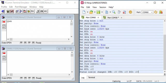

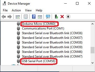

Well,
here are the details of software and hardware setup:
1. Windows 10 x64 LTSC Build 17763.rs5_release. 180914-1434
2. Terminal: Moxa PComm Lite 2.6 (https://pcomm-lite.software.informer.com/download/#downloading) or any.
Choosed because of easy DTR/RTS manipulation.
3. Serial Sniffer: IO Ninja 3.7.4(https://tibbo.com/downloads/archive/ioninja/) or any.
For observation DTR/RTS statuses.
4. Arduino 1.8.9 + VisualMicro 1912.28.2
5. Test sketch based on USBtoSerial example:

Experiment 1
<--> - bidirectional communication;
X--> Arduino to FT232 only
X - does not affect

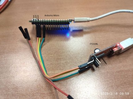

Arduino Micro connected to FT232RL Serial to TTL(3.3V Jumper) @ 115200 BAUD
Rx      Tx
Tx      Rx
GND   GND
	DTR  RTS    DTR    RTS  Communication Status
1.	OFF   X      X      X     <-->	First connection
2. 	ON    X      X      X     <-->	Allways
3.	OFF   X      X      X     X-->	Always
1. After first connection with DTR OFF at Arduino side the transmition is bidirectional.
2. Setting DTR ON at the Arduino side changes nothing.
3. Returning(or futher setting) DTR state to OFF at the Arduino side stops the transmition from FT232 to Arduino.
I guess that the BUG located in the Serial.write/Serial.print region, because the LED13 blinks on receive from FT232,
it means that rd = Serial.available() works correctly.

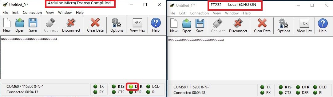

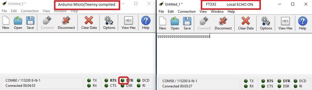

The first thing I did with CoolTerm - repeat Experiment 1
Here are the results. Absolutelly the same as with Moxa PComm Lite.
As to Experiment 2, yes I confirm RTS ON/OFF works with CoolTerm independently from DTR.
It is PComm Lite BUG.
