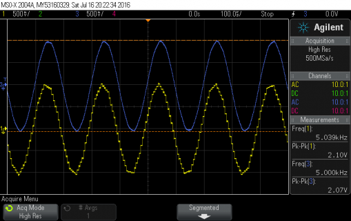

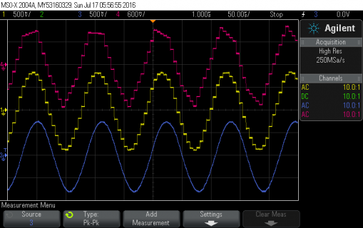

http://dspguru.com/sites/dspguru/files/cic.pdf and I thought I can't mess up too much and implemented a 3-Stage CIC filter (3 Comb and three Integrator stages). And to my surprise, after some fiddling, it works! Have a look at this:
Channel 4 (red): linear interpolation, implemented by Frank
Channel 1 (yellow): 3 stage CIC filter, pretty much exactly what you find in the paper I linked.
Channel 3 (blue): the yellow signal after the same RC low-pass used in the other measurements
This is a 9kHz signal, I chose it because the difference is best visible in this frequency range.

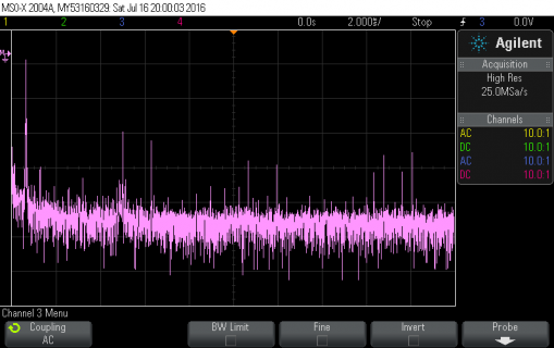

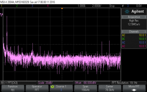

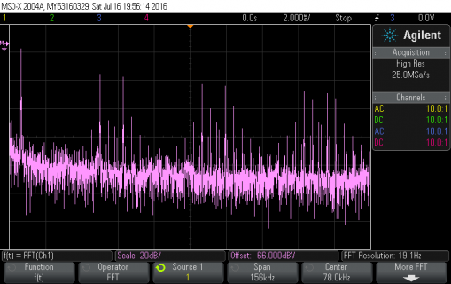

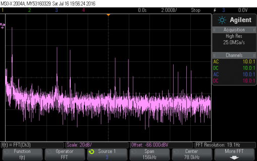

For comparison, here is a FFT of the same 5kHz sine I used to compare OS/no OS and filter/ no filter in post #52. The screenshots are directly comparable, same settings on the scope for all of them, but this time I used CIC filtering plus the RC-low-pass.
Compare this to the last FFT picture in #52, it's even better!
